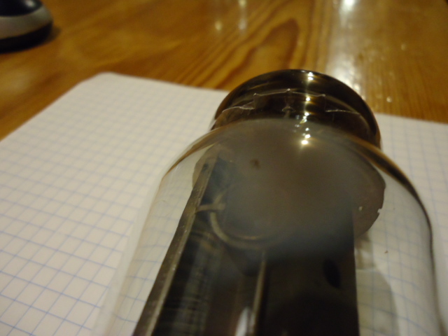

Hello everyone,
I had purchased a quad set of Gold Lion Genalex KT-88's a while back and it appears that one of the tubes is showing signs of getting bad, as the measurement of my DMM is indicated a problem with the voltage reading being out of tolerance. Anyhow, I looked around the web for other info on tubes with good reviews. I found two that I would be interested in, so I would like to ask you guys here if I would be making the right choice. The first tubes are called Shuguang KT88-Z (KT88) Treasure series, and the other would be the (SED) Winged "C" KT-88. The company that has the Shuguang tubes is located in China, but am skeptical of sending money there. Here is the website: Shuguang KT88-Z (KT88) Treasure Match Pair_Beam Tetrode_Shuguang Tube_Analog Metric - DIY Audio Kit if anyone can give me info on what tubes would be my best choice/s, it would be deeply appreciated! One last question- I breifly saw the Emission Labs tubes and was wondering if these would be a good choice, and also wondering if I could get them in the KT-88 size? Thanks for any information!!!

Can you elaborate what you mean by 'Checking the voltage' - Did you put them on a tube tester; or were you looking at the bias ? If you are talking about bias; all tubes will drift at one time or another....What amplifier are you using ? It maybe as simple as readjusting the bias....
Steve, I was refering to setting the bias as my amps have connectors that are located on the top, along with an adjustable pot, that allow me to measure and adjust the voltage.

I would adjust the bias back to where it needs to be; and see how things go over a couple of hours. Naturally tubes age - but the only way to really tell if they need replacement or not is to toss them on a tube tester. I regularly check and adjust my bias every 6mo or so.

Thank you for passing that info to me! I also have the Gold Lions Genalex KT88's, and have had them for some time. I usually check the bias on them from time to time and recently noticed that the voltage was out of range. I tried adjusting the pot, but could not get the voltage correct. I know sooner or later that there will be a failure.

Its not a good thing to run reissue GL Kt88 close to Max dissipation rate. I'd stay within 35-36W Max. I had the same problem with Quad forty II amps and GL Kt88 . It is self biased circuit which runs tubes at 39-40W i.e 90% of Max. After few hundreds of Hrs one of the went into thermal runaway meaning slowly creeping up bias up to the point when undersized 6W cathode bias resistor burned out. There are many stories like that with GL reisue. Its a good sounding tube though. I bought Penta labs chinese uprated Kt88 (also not cheap).
