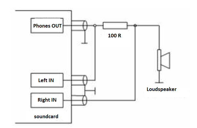

Arta labs has got a powerful limp module to execute impedance, rlc measurements. Would be a shame not to take advantage of it.
Thank you Lojzek
I have never used ARTA, as I thought it's for acoustic measurement only, but I'll try it. I can measure some TS parameters only with digital multimeter, but I don't have proper microphone for acoustic measurements.
