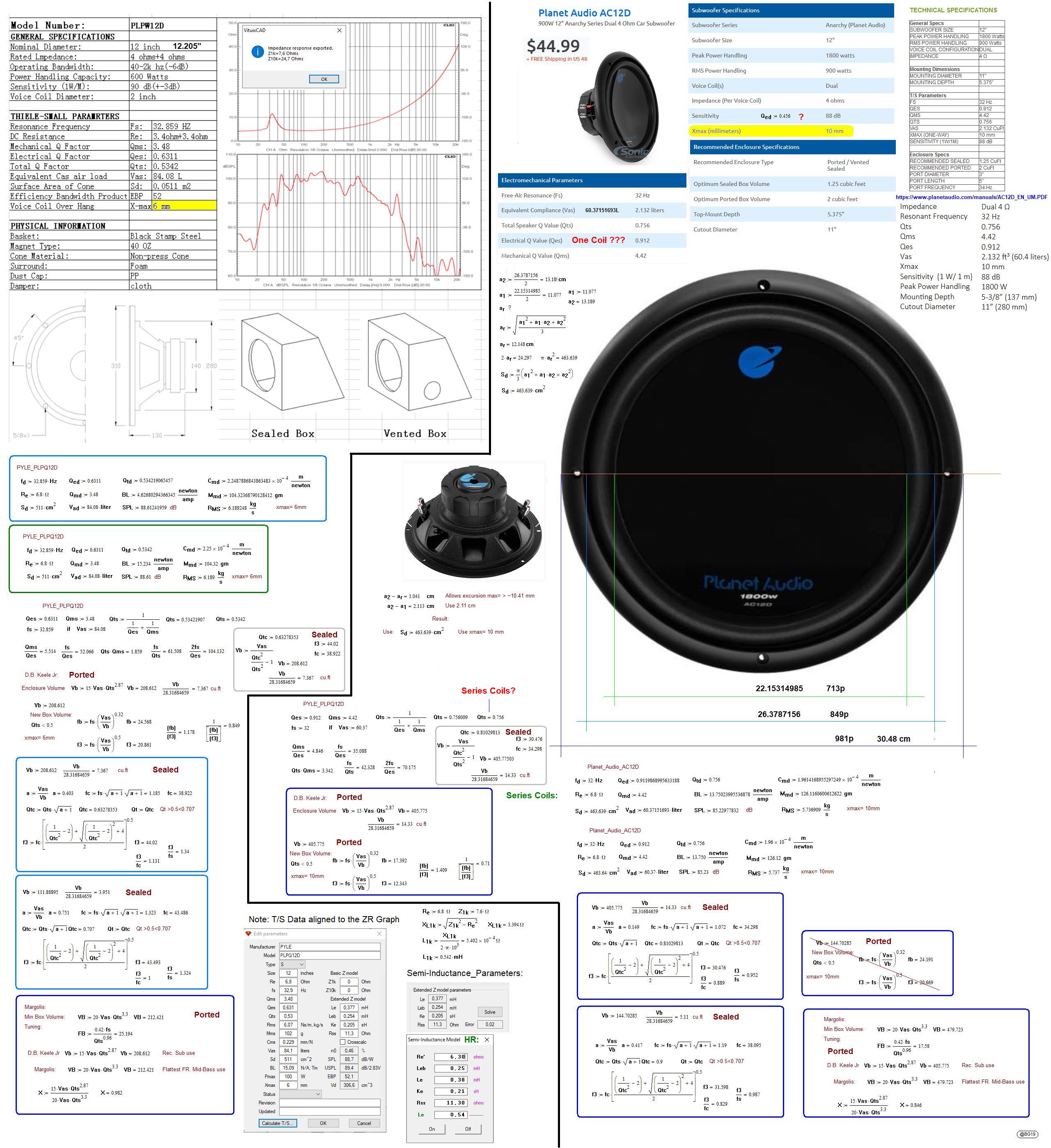

Hello, I am looking into buying a subwoofer but I am not sure what gives you the most bass, could I get any help?
The ones I am looking into is PYLE PLPW12D or Planet Audio 12 Inch AC12D.
But which plays the best bass?
The amp I wanna use is PYLE PLA2378 - 2" Channel 2,000-Watt Bridgeable Mosfet Amplifier.
Regards, John.

Hi John,

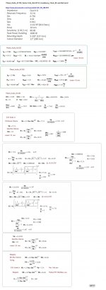

The Pyle Driver comes with almost complete T/S but the Planet Audio Driver T/S is unclear as the given Qts might be for a Single Coil but if in Reality the case are for Series or Parallel Coils Qts=0.4134 when Qes= ~0.456 , then this Driver is IMO a Winner.
