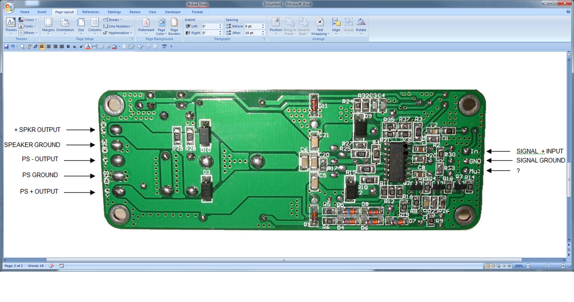

Cristi,
You didn't say anything about an explicit wiring diagram, so I suppose I have to guess.
Are the connections correctly labeled in the below picture?
What is Mu...?
Does any part of the module or SMPS get connected to chassis ground?
What is Mu...?
The connections are fairy simple, same as you indicate in the picture above, there are two connectors only, one have 5 pins, Speaker output, GND, V-, GND, V+ and the other connector has 3 pins, Input, GND and Mute. by default the amplifier is set to operate mode, and connecting the Mute pin to GND will mute the amp. The mute to operate has a delay of ~ one second, to allow the amplifier to operate normally without any click-pop noise.

Every class D amplifier needs at least few supply voltages. a main differential supply voltage for SE power stages, high current, medium voltage (+-25 to +-100+ V) then a driver stage supply voltage in range of 10V to 15V at 50mA to 0.5A depending on the amplifier rated power, referenced to V- and a single or dual supply voltage for the preamplifier, comparator, modulator, and other small signal stages, in range of 5V to 15V single or dual.
Most of the amplifiers which I built have house-keeping power supply circuits which supply this voltages derrivated from the main power stage voltages, more or less efficient, using linear regulators or switching regulators (buck converters). both have advantages and disadvantages, they are far from perfect. linear regulators are less noisy, but waste power, and switching regulators add noise which have to be filtered somehow, and this in turn leads to increased complexity.
With CxD250-HP I tried to get rid of all the disadvantages mentioned above, obtain a high performance, high efficiency and low noise amplifier, regardless of complexity. So I chose to supply all the voltages from external independent sources. the dedicated power supply for CxD250-HP which will be available soon, will provide all these necessary voltages.
My observation regarding the extra power supply was for the driver stage supply voltage. SMPS2000R aux. output will supply the input stage voltage, +-15V and the speaker protection circuits will be supplied from the additional small power supply used for driver stage as well, but with isolated output, not common with the speaker protection boards.
My email is working relatively fine in the recent weeks, but I wont be surprised to have issues again anytime soon. the reason I believe is the large number of mails received and sent every day, but I don't exclude some malware as well, I had to re-install wingoz last week after a serious system crash. I use to read and reply mails on few computers, at work, home, on my laptop and mobile devices for urgent ones.
