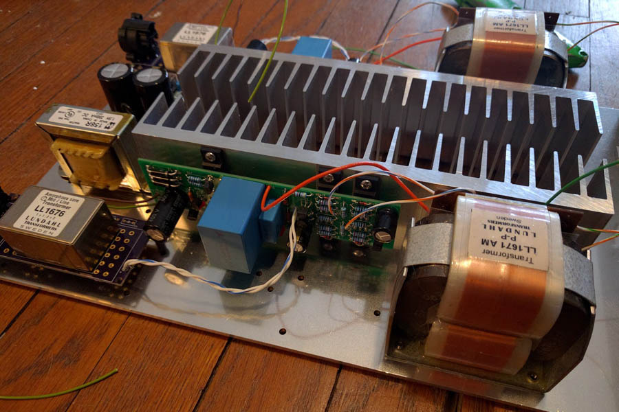

I'm using some Toshiba 2SK3564's.. They also have the isolated tab so that you don't need a mica insulator. They seem to do the job well.
They also have protection zeners between gate and source built in, so that's nice.
It's based on two things. My own simulation and a comment (sorry I don't have the thread at my fingertips) by Trobbins of an article that said IM distortion was reduced if the bias was set that way. That seems to be consistant with what I was simming. The split load voltage excursions seem to modulate each other a bit if it is not biased in that way.
Here's the article that I think Trobbins was referring to:http://dalmura.com.au/projects/williamson_verstaerker.pdf
Does the plastic insulated tab mean it can be screwed to the heatsink without the use of a mica spacer kit? Just thermal grease and that's it?
That's what I do.

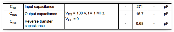

Toshiba TK10E60W would be worth a look - although its gate capacitance (700pF) is higher than the IRFBC20 (400pF) this is largely bootstrapped in a source follower configuration. The other two capacitances are lower. Its also got half the thermal resistance (junction to case) of the IRF so will run cooler and hence potentially have higher gm.
<edit> On second thoughts, scratch what I wrote about the capacitances - the headline figures are given at different voltages (25V vs 300V) - this makes a really substantial difference in favour of the IRF on the output capacitance.
