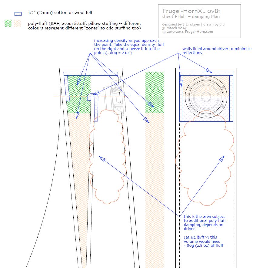

I am planning to build this enclosure recommended for the FE168ez Fostex driver, however I am also interested in trying the FE166en and FE2016en. Does anyone know if these other two drivers would be a good fit for that enclosure? I'm a total newb when it comes to rear loaded horns... Thanks for any help!

Any reason why you've chosen that BLH? Probably not a good idea to stuff a different driver in there only to be unhappy with the sound after a lot of effort and expense.
If you like the 166 how about a BIB? Simple to build, lots of bass gain (in corners), and designed for the actual specs of your driver. More complex but I believe I remember a horn designed by Ron for this driver a while back.
Good luck!
Honestly I'm looking for an enclosure that I can use with many different drivers until I find a driver that I like the most. I would like to eventually end up with some lowthers but I will work up to that kind of expense. I'll take a look at the BIB again.
Well, if you want a horn that you can try a variety of drivers in: bigger is better. To a point anyway. Aim for the largest you can manage, and damp out any excess gain when necessary. Obviously this has issues if you start trying to stuff 3in drivers into something designed for an 8in unit, since the expansion path, throat etc. will be a long way off what the driver needed, so if you want to take this route you should avoid excessively dissimilar driver sizes.
If you want one of the Fostex cabinets, the 206 in the 208ESigma enclosure works well. The FExx6En cabinets (they were actually designed for their FExx6E predecessors) aren't great IMO, but you can get reasonable results from them in the equivalently sized FExx8ESigma horns. The BIB tapped pipe-horn is also a good route -as simple as it gets, so build one with the largest volume / cross sectional area you can manage for a given length if you want to try a few units and again, damp out any excess.

Thank you everyone for the advice. I have pulled the trigger on a pair of Fostex fe166en in the FHXL. I am now curious if anyone would recommend a Zobel or other correction net work for these drivers?
Hello .
I recommend you to listen to your speakers a few hours before planning a correction circuit. It also depends on the amp you use, the speaker cables, and the speaker placement.
What I can advise you is to add a resistance of 1 ohm to increase the QTS. It will give you a better headroom in the low frequency at the expense of only 1db loss of efficiency. This will be helpful especially if you have a solid state amplifier. Zobel can be a good idea if you have the feel of too much treble or a harsh sound in high frequencies. But the better filter is no filter, just amp, cable and speaker if you can !
Guillaume
Not sure if you've ordered wood or not, but this box doesn't seem to be what you're looking for, according to your earlier posts. While flexible for Mark Audio Alpair 10 drivers and the FF165wk, the fe166en may not work well and a Lowther probably less so. Of course you could always ask the guys who designed them. 🙂

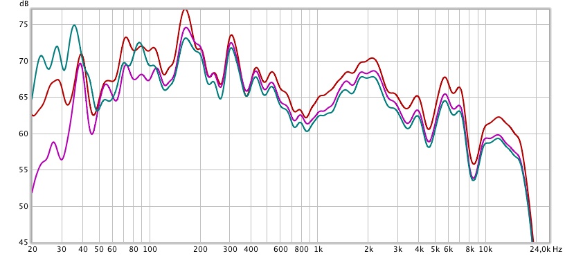

influence of NFB
The influence of NFB seems important with full range drivers.
From my listening place pink noise recording at 7OdB (my normal listening level) using 1/6 octave, for a Fe168e∑ in Fostex back loaded recommended enclosure
Purple curve is without NFB and green one with 10dB NFB. The red correspond to my taste.
  • CR 1:6.jpg
    CR 1:6.jpg
