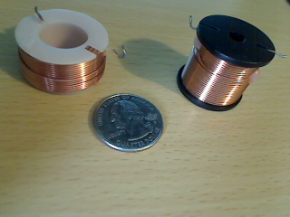

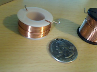

I lost a pair of air core inductors. help please.
Dear friend. While trying to upgrade my speaker crossovers.I trashed by mistake a pair of original air coil inductors.
I know how important is DCR on the original crossover network.Here are the values:
Mid-range coil:
0.418 mH
0.6 ohms
0.8 mm diameter
Tweeter coil:
0.228 mH
0.4 ohms
0.8 mm diameter
I know these are the correct values.A friend measure them for me.
Could you please help me find the coils to match my speakers.I miss them so much.Your help would be appreciated.
I forgot to mention ....that i found a web page that have some coils.
Here:
Jantzen Inductors - Core Round Wire
Let me know what you think. Thanks in advance.
