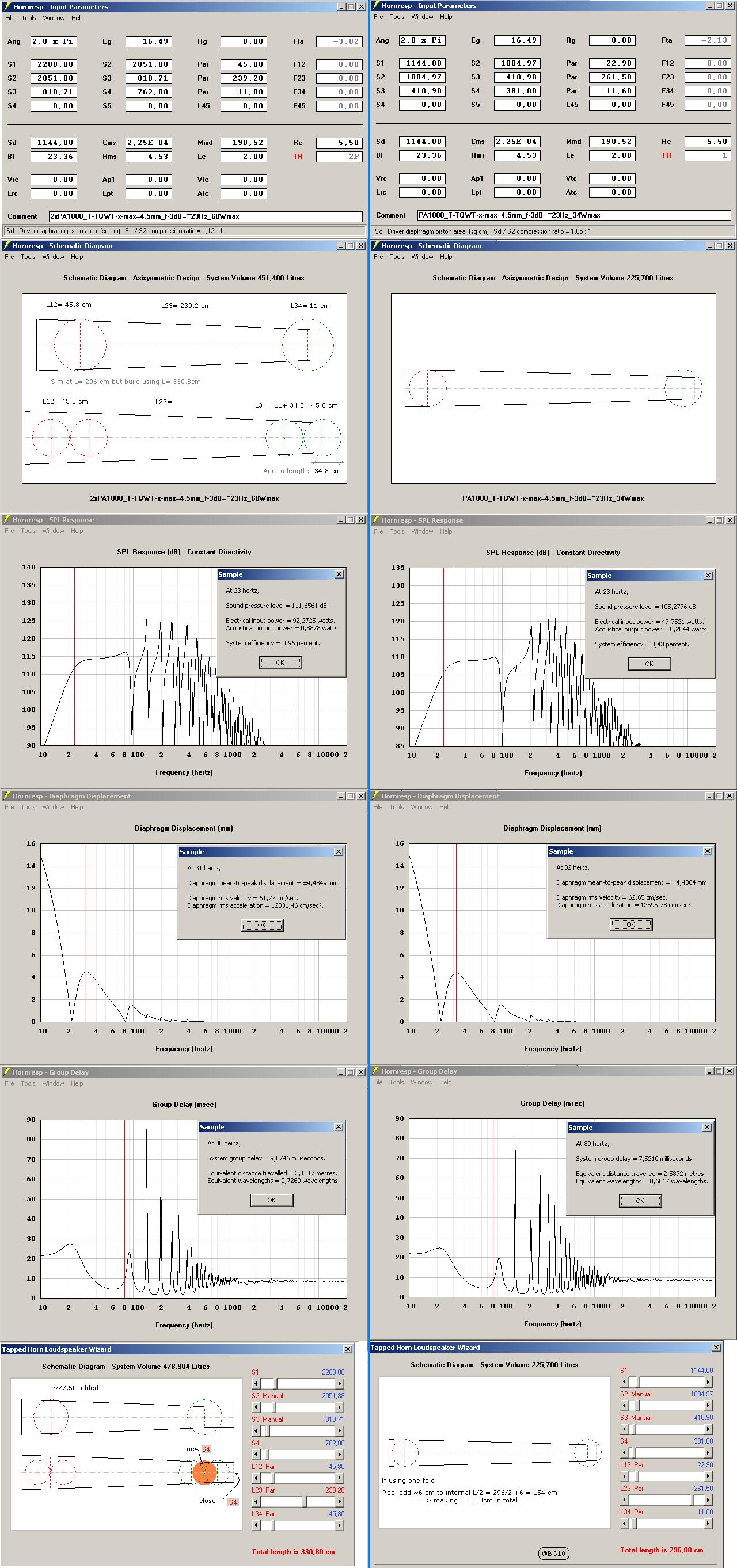

dynaBel PA-1800_T-TQWT
FYI:
b🙂

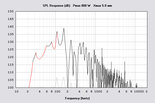

A compound reflex port/front horn @ about 220 Liter net has a nice impulse response in Hornresp. A bit bigger than a standard BR, but may be worth the effort to match with the Iwata/LeCleach horns mentioned above.
A 600 Liter tapped horn would average about 109 dB in the pass-band, and provide 106 dB @ 20Hz; this is driven to Xmax=4.5mm with Eg=14V. Not very impressive (?).

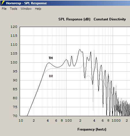

I have no use for 20hz-response, is it possible to tune the system a bit higher to gain SPL, or do you have to tune near FS when building horns?
A tapped horn tuned to a similar low end corner as the BR will be about 300 Liter, and be about 1.5 dB more sensitive. I recommend you fire up Hornresp, and give it a try there are just too many different results that can be achieved in a simulation.
My recommendation would still be along the BR/front horn line.

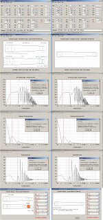

Yeah, just running the numbers tuned to Fs, it gets pretty big at ~409 L net with the high Vas, but with 800 W on tap it has good enough dynamic headroom for a HIFI/HT app (2pi):
GM
