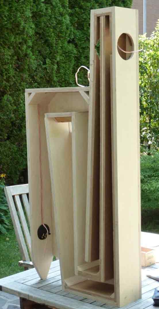

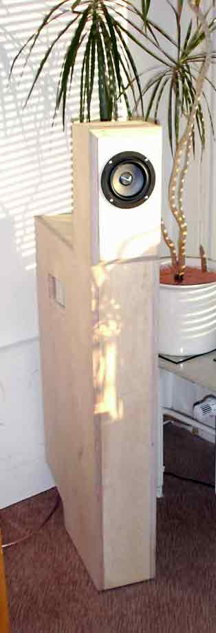

Hello,
what enclosure typ and size you prefer,
one of my smallest and best solution would be the Kornett.

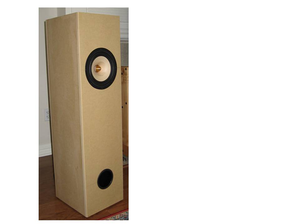

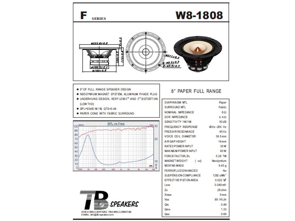

Hi onform,
I'll cast one owner vote for the Tang Band W8-1808. Great vocals, good bass below 40Hz, the highs above 6Khz are clean but do have some SPL wizzer wiggle. ~$190, I paid $144 during a sale.
A tall Bob Brines MLTL design provides a good listening height. The cabinet is a 100 liter MLTL – 48” x 10” x 12”. The speaker is mounted 12” below the top edge with a 4" diameter 2" long port 5" up from the bottom. Very easy construction.

Tang Band W8-1808.
I've had a couple pair of those thru here. I prefer it to the 1772, but, with the exception of the quantity of bass it can produce, wouldn't put it over the Alpair 7 or 10.2.
Besides being way over the OP's budget the difference between it and Alpair 7 could buy some nice midwoofers to fill in where A7 lacks vis-a-vis the TB.
dave

Steviedon,
Bob Brines posted this W8-1808 MLTL design on a public full range forum, and I mentioned him to give thanks for his DIY support. Bob provided just enough information for the simple MLTL construction, but naturally not the full details that go into the MLK spreadsheet.
Tang Band provides a BR design of similar volume.
Vocals on the W8-1808 are captivating. Natalie Cole, Kathleen Battle, Old Blue Eyes, Tuck and Patti, Diane Krall, Diane Schur, Kate Bush, Linda Ronstadt, Sade, even Big Guy Tenor opera arias. An 8" full range in a simple MLTL goes down to the 40Hz string bass of Miles Davis Kinda Blue, and I think this is one reason 8" are so popular and worth the higher cost over a 4" to me.
