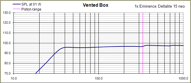

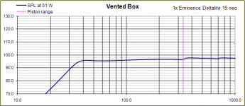

Mr. Unibox says Yes. Looks like an EBS alignment for the Deltalite, similar to the 416.
F3 of 36Hz. Could also go in a 200L box and lose some on the low end.
Hmm, a 200 L cab can't be an Onken due to excessive vent length, at least not without stuffing the vents to make them ~aperiodic, nulling out the performance part of the Onken's allure.

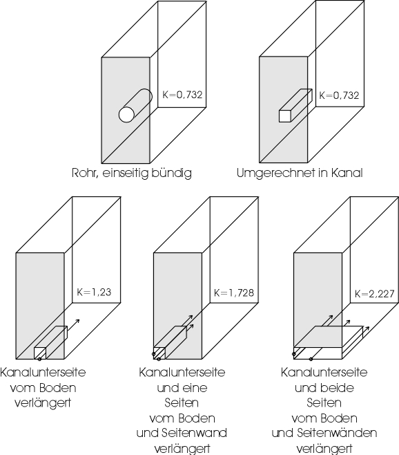

Can you help some on the end correction factor? Unibox allows it, but I don't know much about it, other than the canned factors it comes with.
E.G., how did you arrive at 1.728 for the Onken vents? I was using 0.723 (one flush end)
P.S. Looks like I was wrong about the 200L box. 240L, maybe.
Different boundary scenarios affect how much it impacts a duct's effective acoustic path-length with more boundary conditions causing an increasingly shorter physical duct length.
