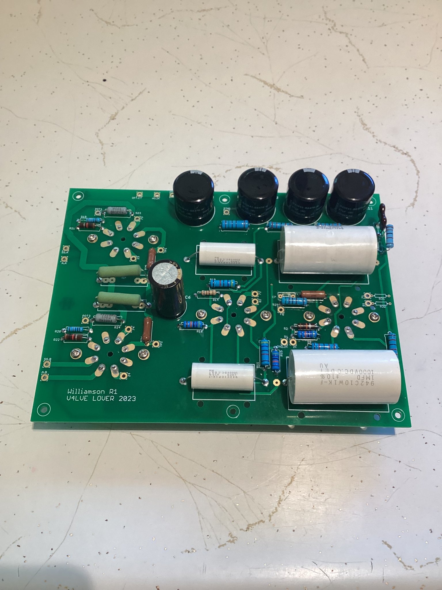

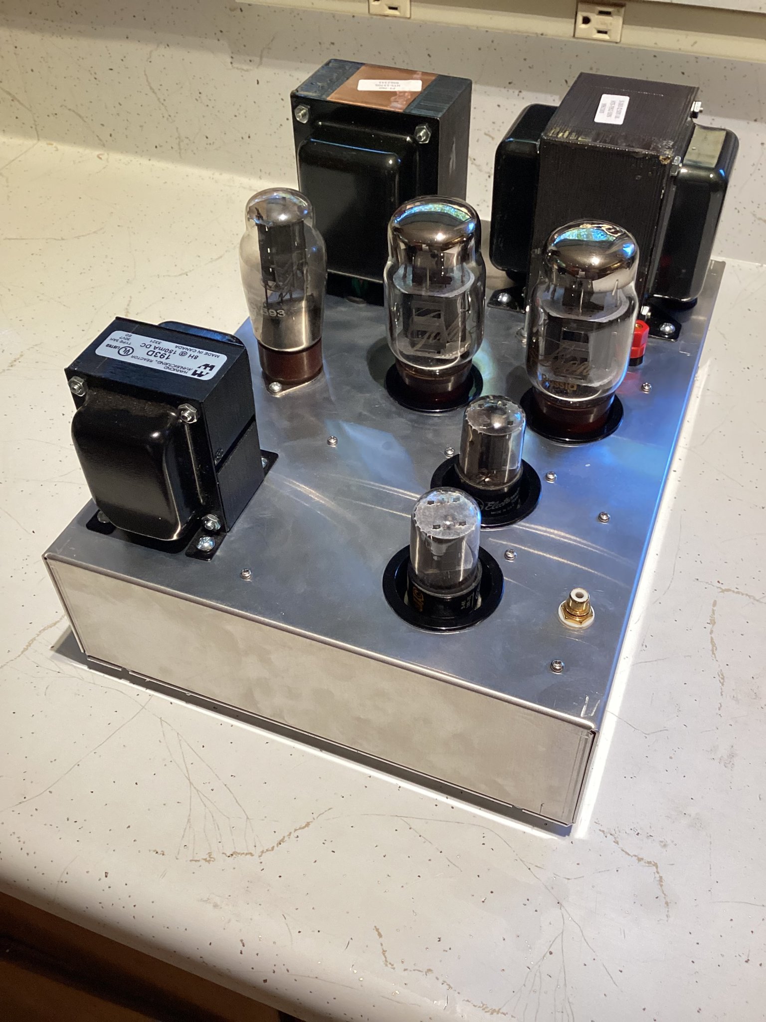

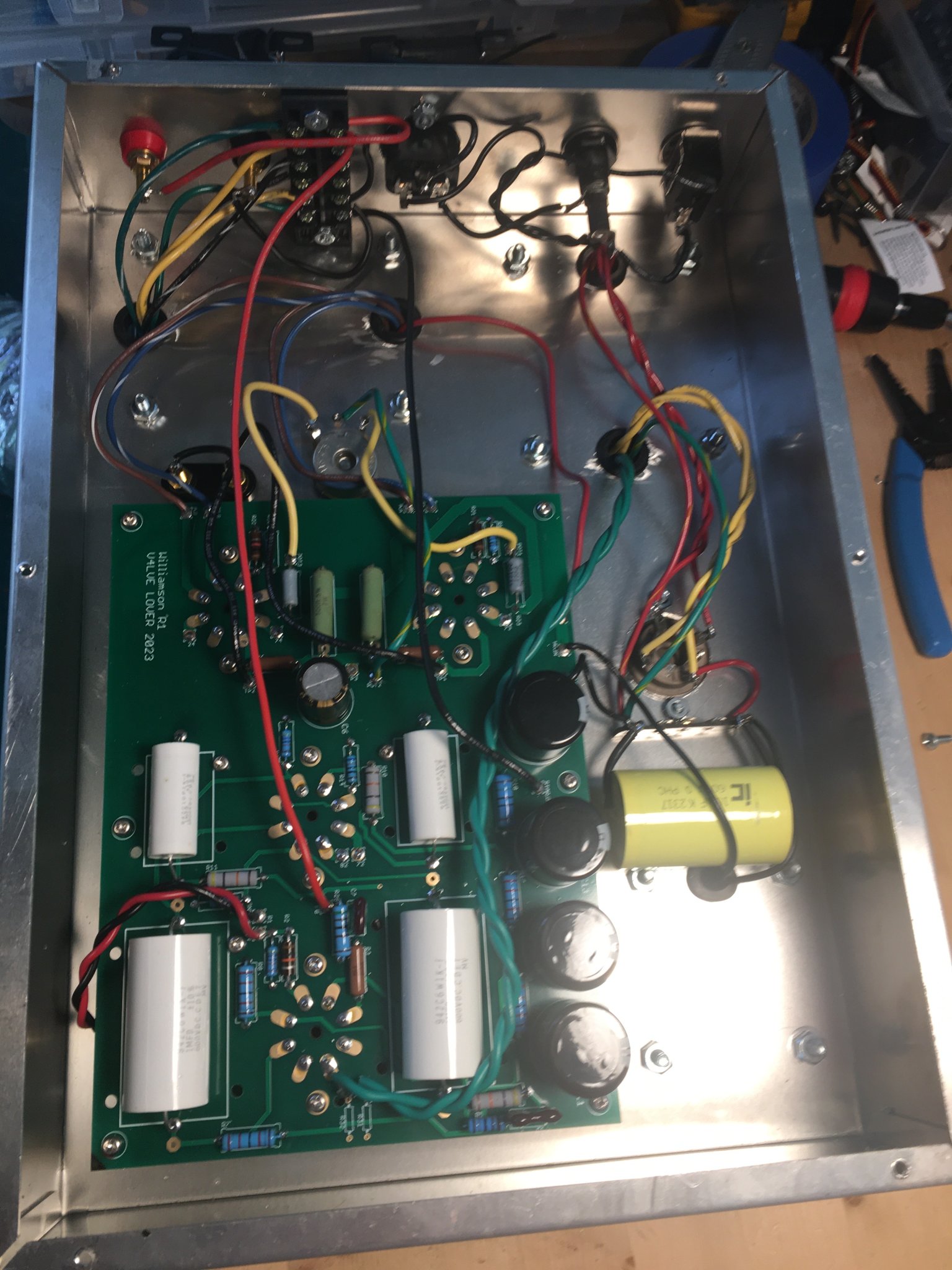

I recently commissioned a PCB for the classic Williamson from a fellow forum member. It's a 6" x 8" board that holds everything except the transformers, the rectifier, the first capacitor and the balancing pot for the output tubes. The power trannies and chokes are available from Hammond, and the recommended output transformer is a copy of the marvelous Peerless S-265-Q output transformer made by Heyboer. I'm contemplating a "kit" but that involves a huge amount of planning and investment and I'm not there yet ;-). I built a prototype, which you can see below. The cost was about the same as the Elekit or Dynaco kits, around $1200-1500 for a pair of monoblocks. That may seem like a lot but these do not sound like DIY amps. They have authority and terrific frequency response, and they are VERY stable. Most importantly, they get piano right. ;-) If you can get a good simulation of Horowitz at Carnegie Hall, you're doing pretty well.
There's also a version of the Williamson with Edcor transformers that a fellow DIYer designed, and which could be easily implemented with this board. It would be a bit cheaper. But they Heyboer Peerless copies have been evaluated by a well-known expert over at Audiokarma and he gave them a big thumbs up for performance.
