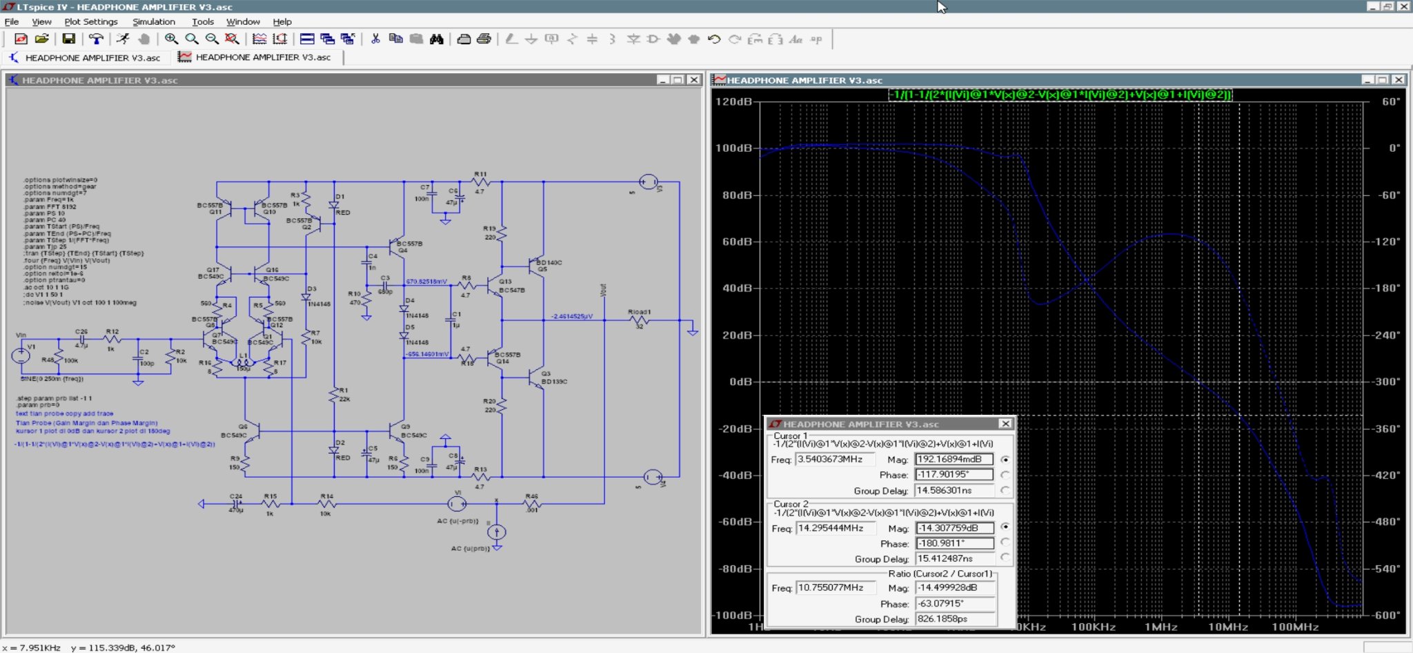

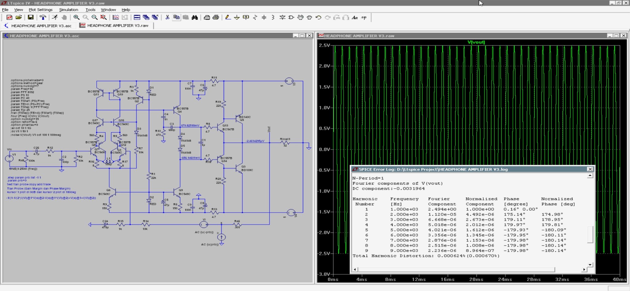

R Rwan Member Joined 2024 2025-01-15 2:29 pm #1 2025-01-15 2:29 pm #1 1 2 M MarcelvdG Member Joined 2003 2025-01-15 2:53 pm #2 2025-01-15 2:53 pm #2 Probably 2. While 1 has slightly less bass roll-off at 16 Hz, it will be more affected by load impedance variations due to the output coupling capacitor. Your distortion simulations look like settling is incomplete. Last edited: 2025-01-15 2:58 pm Reactions: Rwan R Rwan Member Joined 2024 2025-01-15 3:01 pm #3 2025-01-15 3:01 pm #3 Thanks 👍 R Rwan Member Joined 2024 2025-01-16 3:52 pm #4 2025-01-16 3:52 pm #4 Is it ok? 🤔 M MarcelvdG Member Joined 2003 2025-01-19 10:28 am #5 2025-01-19 10:28 am #5 The loop gain plots look good to me. The distortion simulation results look good, but I can't see whether settling is OK without a spectrum plot. Reactions: Rwan You must log in or register to reply here. Share: Facebook X (Twitter) LinkedIn Reddit Pinterest Tumblr WhatsApp Email Link
