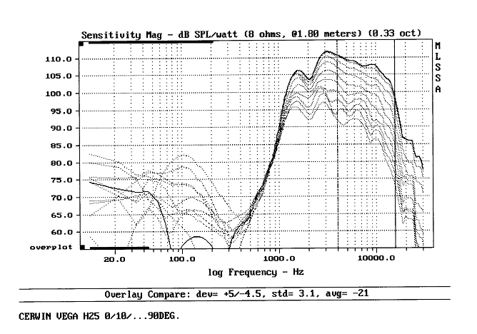

Friend has a pair of old Cerwin Vega PD-3 PA speakers which need midranges-not just diaphragms, there is a hole where the midranges used to be.
Found out the midrange on this model is the Cerwin Vega H25.
Looking at the frequency response, which I found here, I noticed that this unit seems to be putting out 112 dB @ 1M/1Watt.
Chart is reproduced below.
Win ISD will not allow simulations above 106 dB at 1M/1 Watt.
Small's chart for bass response tops out at 112 dB at 1M/1 Watt.
Seems to me this chart shows the Cerwin Vega, through part of it's band, as being either 100% efficient or 400% efficient, 6 dB meaning 4 times the power. Even 100% efficiency seems far fetched, 50% efficiency is superb.
Any help understanding this would be appreciated.

This is dependent upon the radiation pattern of the device. Remember, when you measure 112 dB you are measuring the intensity (power per unit area) at that point, not the power being radiated by the device. The reference intensity I_o is 10^-12 watts/m^2, and SPL is given by
SPL = 10*log(I/I_o) = 120 + 10*log(I)
so if you have 1 watt of full space radiation you get
SPL = 120 + 10*log( 1w / 4pi ) = 109
or in half space you get
SPL = 120 + 10*log( 1w / 2pi ) = 112
If, for a rough approximation, you treat the device as if it has uniform axisymmetric radiation with an exact beamwidth of x degrees, then the area radiated over at 1 m is 2*pi*(1 - cos(x/2)) so the SPL for 1 watt of radiation is:
SPL = 120 + 10*log(1 / 2*pi*(1 - cos(x/2)) ) = 120 - 10log(2pi) - 10*log(1 - cos(x/2)) = 112 - 10*log(1 - cos(x/2))
A couple sample values:
BW SPL
360 109
180 112
120 115
90 117.3
60 120.7
I hope this helps
Nolen

If the loudspeaker has 100% efficiency and if it is fed with 1W of electrical power, the acoustical power will also be 1W. This power is distributed over a sphere, in this case we look at a radius of 1 m.
If the loudspeaker is omnidirectional and radiates in full space, the power will be evenly distributed over the surface of 4 pi m², and the intensity will be 1/(4*pi) W/m². This corresponds to a sound intensity level of 10*log(1/(4*pi*10^-12))= 109 dB.
If the loudspeaker instead radiates in half space, power is distributed over the surface of the half sphere, which is 2 pi m², and the sound intensity level becomes 10*log(1/(2*pi*10^-12))= 112 dB.

Thanks for the conversion info- now things make a bit more sense. I was always led to believe that driver efficiency was dismal, like a couple percent at best. Now it seems that things aren't quite that bad.
