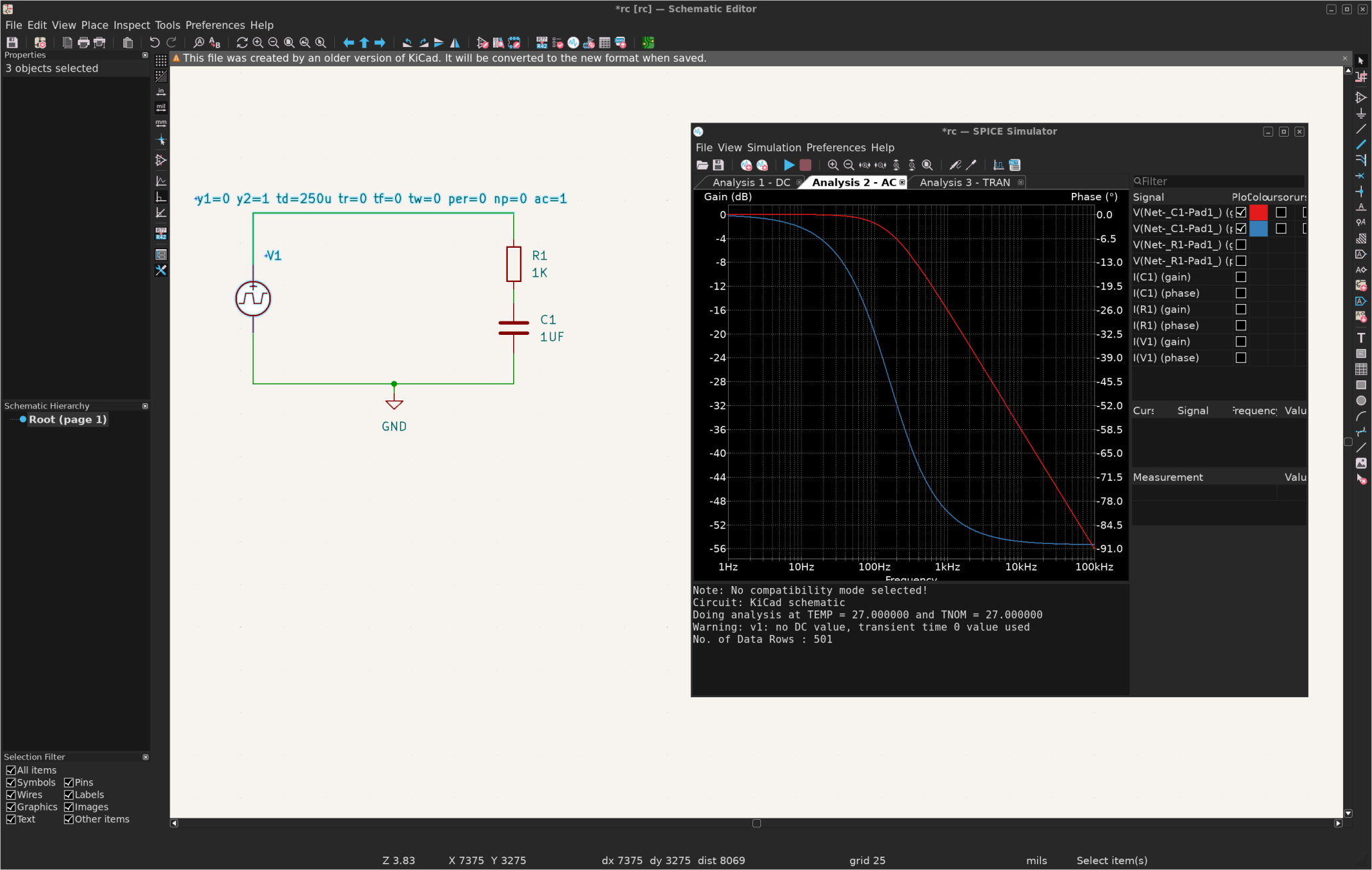

I have been tinkering with SPICE simulators for several weeks and I am still a dope. My options are limited because I use only Linux and can't afford a Windows license just to run one application. Most of the spicers are just for Windows. Qucs-s is interesting because it is OS independent. KiCad works on Linux and has a concept of simulation but I am no wiser after doing the beginner tutorials. I also did the NgSpice command line simulations but I could find no practical applications.

KiCad can call Ngspice and graph the results on Linux. The GUI is somewhat buggy. I have run only trivial tests so far.

I had some luck today. I modified the KiCad8/sallen-key demo to be a simple amp instead of a low pass filter. There is an option to print the NgSpice commands. I believe I can do something useful with KiCad spice.. fingers crossed.ngspice runs on linux as you discovered. I use it. ng does have a primitive plot tool. It also can output a simulation run to a file and you can do whatever you want with it. I don't use KiCad, are you sure it cannot interface with ng? I'd be pretty surprised if the Qucs is usable if it is OS independent. The Independent usually means java, which is not going to be fast for things like moderate/large transient simulation.
