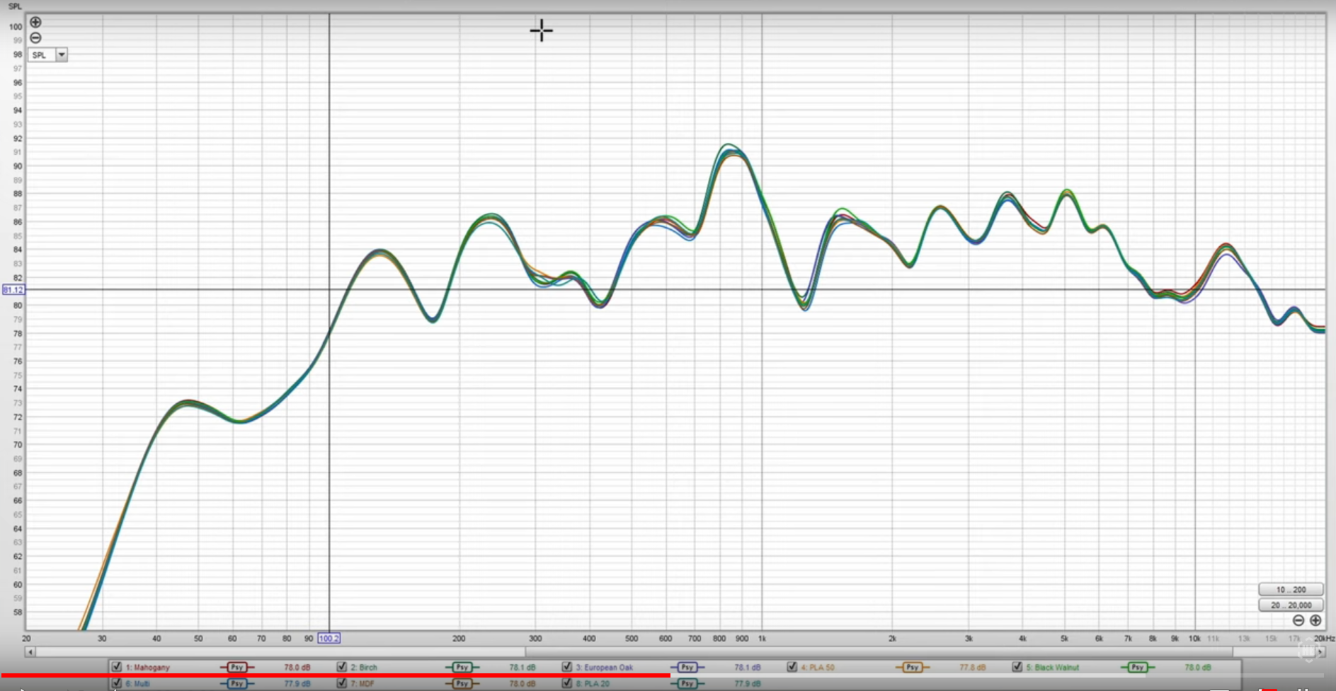

Interesting, the speaker response from 45Hz to 20kHz was +/- 9.5 dB, while even including the worst-case no-fill plastic "outlier", the response deviation between all the different materials was less than +/- .75 dB.
I have yet to measure two of the same type drivers that have that little deviation between a pair.

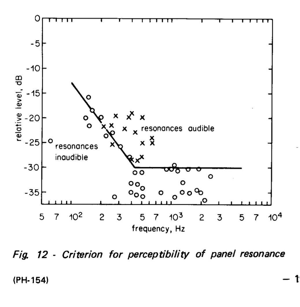

BBC's view on cabinet resonance audibility
http://downloads.bbc.co.uk/rd/pubs/reports/1977-03.pdf
I've re-read this article a few times and don't really understand 90% of it, but it has one little diagram that did hit home with me (first attachment)
It shows that midrange resonances are easier to hear than bass-range resonances.
They show in the article that lighter panels are easier to dampen which brings the resonances down into the "harder to hear" bass range.
I tried a build with thin walls and lots of damping and it was a fun change from my usual 3/4 ply routine. They are subjectively less resonant when you tap them. And music can't be felt as strongly through the walls. Anyway, I might post some pics here soon.
Unfortunately it left most BBC monitors with a fattish coloured bass. Most owners like the coloration. Sales of the big Harbeth’s an example.

1st question: Why didn’t he use the factory gasket supplied with the driver? Given the FE166 basket his sealing may be flaky. Given the consitency of the measurements he may have gotten away with it
Don’tknow how much he showed, mostly just looking at damping.
That isn't quite right. The BBC's objectives were to design cabinets that were light enough to lug around, straightforward enough to manufacture using the technology familair and available to low-tech speaker manufacturer's of the time and with a performance that was just about good enough to do the job rather than high performance.
What the approach does is exchange a worsened low frequency resonant behaviour in order to gain an improved one at higher frequencies which as your plots shows is audibly more intrusive. They used simple and crude extensional damping in large quantities rather than something with a better performance like CLD which they were aware of but judged too complicated. Ditto for better materials than wood. Sensible engineering compromise for the times that the audiophile fantasy machine seems to have turned into something exotic and magical particularly here in the UK.
