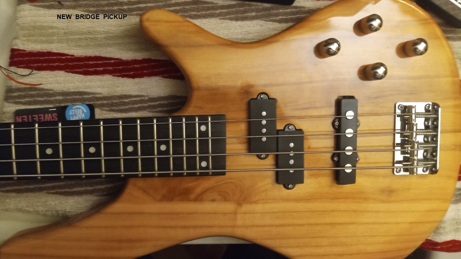

on a whim I bought an Artec ceramic Big Pole Jazz bass pickup set to go into a glarry 'GIB' P-J' bass. DCR on the coil is pretty low - inductance seems pretty high due to the relatively large steel pole pieces and would assume the alnico version to have a good deal less inductance (how much vs steel? I installed the neck pickup of the set at the bridge as its spacing was correct for the glarry's bridge cavity. (hopefully the neck pip isn't much different)
Until its setpu better i won't be able to evalue the new pup and how it might blend with the Glary P=pup but assume it wil be fairly thick sounding w/o a lot of tonal complexity.

I'm wondering if on my Glarry "GIB" PJ bass if I can come close to the sound of a Music Man Ray2 passive bass. The distance from the nut to the center poles of the Glarry's jazz-bass bridge pickup is 31.25". The current bridge pickup is an Artec ceramic magnet "Big Pole". Maybe a shunt C and series L? (are there any measurements for the various MM pickup and its cheap aftermarket clones ?
I can't judge sound quality til set up an amp and cabinet - my Joyo $14 headphone amp is pretty awful and the Wilkinson ceramic M series -P-bass plus Artec Big Pole Jazz pup sound little if any different on it than stock pups.

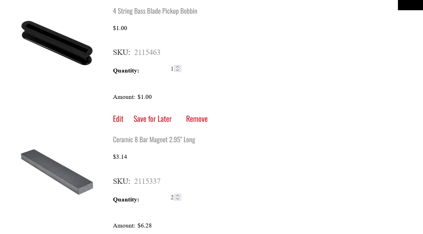

Artec's ceramic magnet "Big Pole" Jazz-bass pickup sounds like its >10dB weaker than the Wilkinson M-series P-bass neck pickup. I'd like to try adding a magnet to the Artec Jazz pickup - are there any ceramic (or other) bar magnets in that width that are inexpensive and in the US that would be appropriate to add to a Jazz bass pup?
