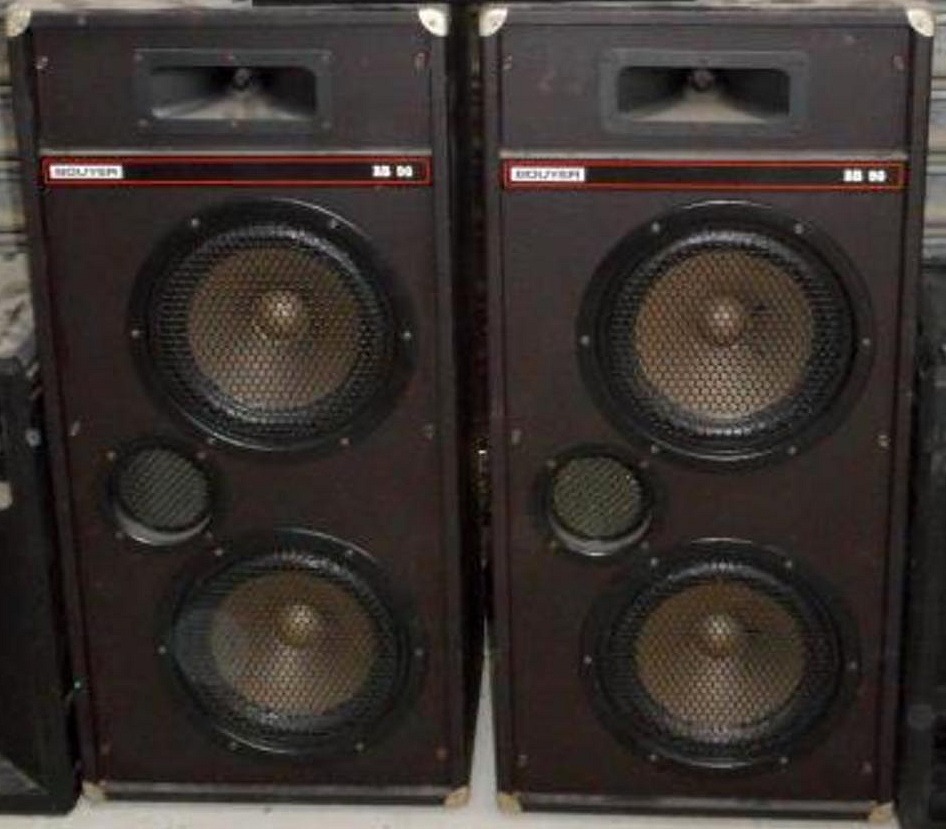

I've a pair of Bouyer RB 90 speakers (picture below) which I'd like to use as a stereo pair. They measure about 88cm x 40cm x 30cm. On the back they're marked Impedance = 16Ω, power = 80W.
In a nutshell: which model of stereo, Bouyer amplifier should I look for?
- Can anyone recommend a model and specification of Bouyer stereo amplifier that goes with these speakers?
- Do I need to use a preamplifier too?
- What should be the impedance of the main, stereo amplifier?
- Does the amplifier's power rating refer to 'per channel' or 'both channels' and which should I apply here?
- Does the amplifier's impedance refer to 'per channel' or 'both channels' and which should I apply here?

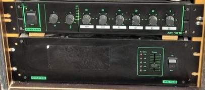

Online, I've found the following (foggy) pictures of amplifiers associated with the Bouyer RB 90's. (No guarantee they're an appropriate amp choice!) I'll try to find out what these are. (Bottom one is an AS 105.)

PS The upper of the green and black pair of amplifiers shown above, seems to be a Bouyer AP1010.
Here is another pair of Bouyer amplifiers said to work with the RB 90's. These are (upper) AP1010 and (lower) AS150.
The speakers are 16 Ω and use two identical speakers, so those must be wired OR in series OR in parallel. To exhibit a 16 Ω nominal load, the two woofers are 32 Ω if wired in parallel, or two 8 Ω in series. The power ( max 80 W ) is shared between the two ( plus the tweeter), so it gives a figure of 40 W power handling each speaker. Now put a no-brand amplifier that elevates the voltage from its input like all the amplifiers do, and give gain and listen. If it's not enough, try more than the usual 30-50 W but the 80 W limit is still there, despite the not-so-perfect impedance matching - which is not true! It's true for output transformer coupled circuits such as tube amplifiers.
Solid state loves high Z! ( not true: it gives a little more resistance so it's a little harder to drive, but the opposite, low Z such as a 4 Ω load, is more dangerous since current flows much more) - indeed they love it!
