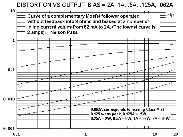

Hello
Tube amp do not have the spray of thd spectrum, especialy hf thd, that we find in some types of transistors amps.
Did you made a 300B tube amp ?
But some topology of transistors amps can sound very musical. And matching ltp transistors, using a fast and low cob VAS trany, using a phase lead cap and keeping a low nfb factor will help a lot.
Mosfet amps need a minimum of bias to sound better, we can see it at the image of a graphic from Nelson Pass. If you use mosfet with a higher bias you will have a better sound, that's why the Nelson Pass's First Watt and Pass Lab mosfet amps sound so good.
Bye
Gaetan

Now let's look at Nelson Pass class-A designs. He can achieve such a high quality sound with simplicity. But it has a limit. Many cannot hear the difference in mosfet capacitance. But for me, the capacitance is clearly the limitation of a mosfet amp. Very easy to hear, even in the output stage running in class-A.
What if the mosfet is in input or driver stage? Even worse!! BOZ, Aleph, D1, etc. JLH used VN1210M, Alex Nikitin cleverly choose ZVP3310A in follower configuration, but many new designers use IRF610 and higher capacitance devices! Some even use IRLD123 in the input stage. If you can't hear the problem, I can. Some others can hear the problem but don't know where it comes from.
Good or bad is relative. In intermediate level, bipolar amps are often better than mosfet amps. In ultra high end level, mosfet amps still has to work very hard with its capacitance problem (thus non-linearity, distortion etc).
