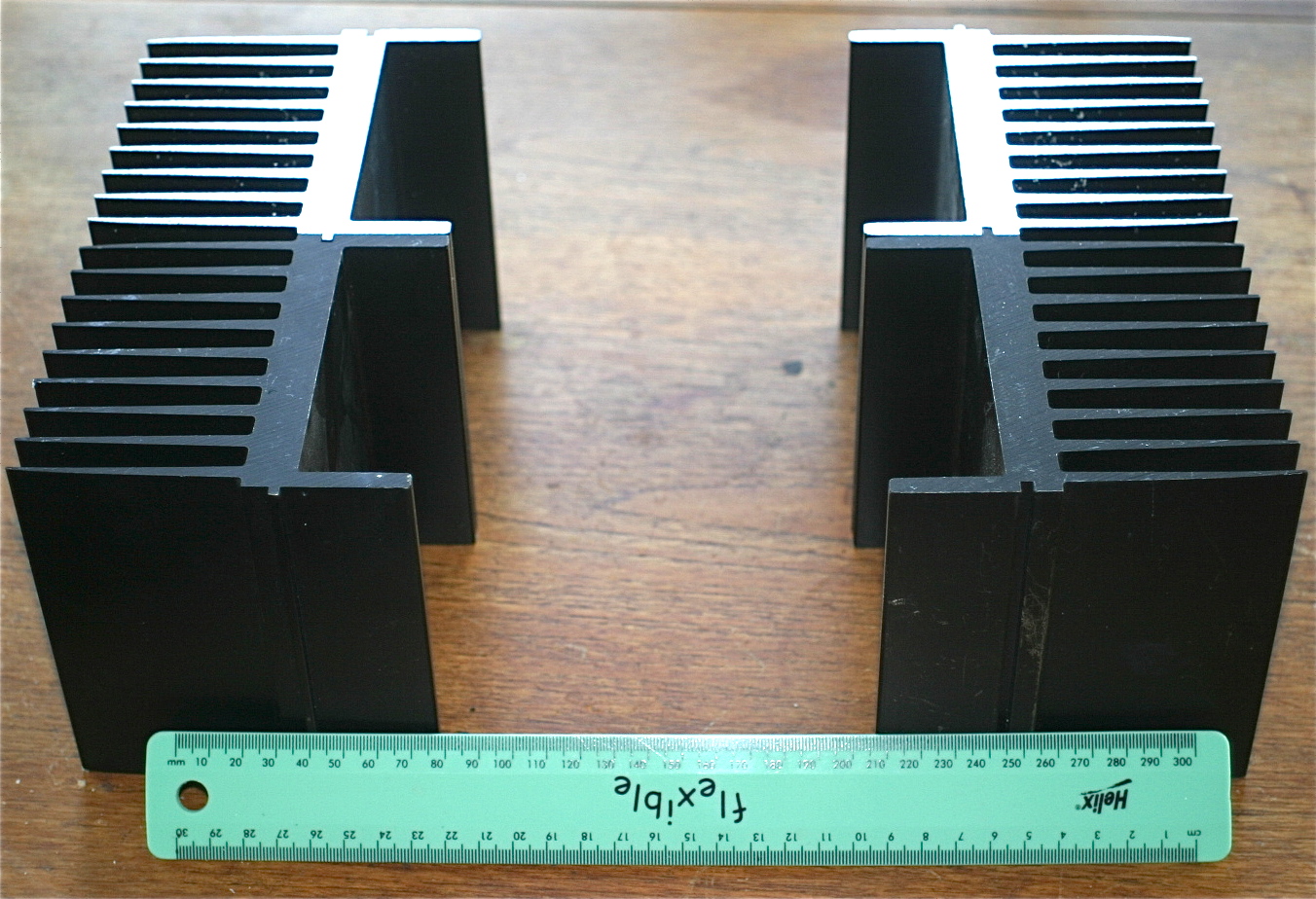

I have almost no experience of building a solid state output stage, but I build all my tube equipment. Know very little about Mosfet circuit theory, though enough to know I want class A and no caps in the output. I have most of the hardware - 25-0-25v (approx - could be up to 35v) power supply in different box, and some big heat sinks.

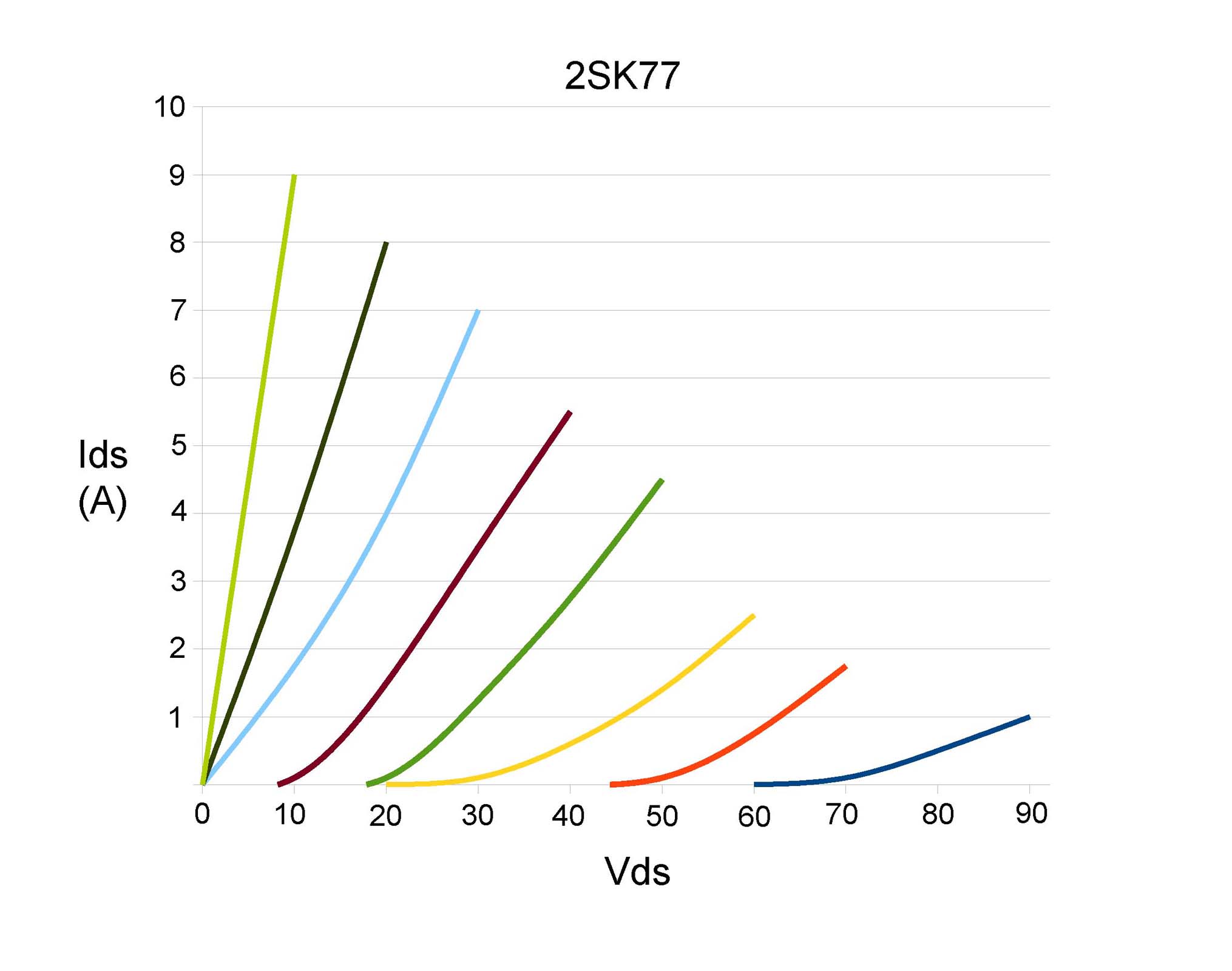

I wonder how far we are away from such a device...... tube builders are more used to seeing curves as below - wonder what they look like for some of the SIC devices....
Or at least something rather like it. I mean, how many tube amps are there lying about with OPTs just ready for such things. You might need something that would work into a 3K to 6k primary. Push pull should be fine (then there's parafeed....).
