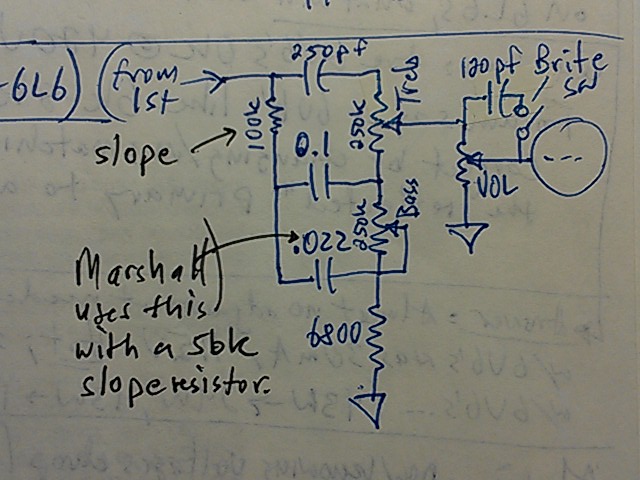

I have a Bassman on a breadboard, had the tone stack between the first two 12AX7 stages, then moved it to after the 2nd stage (then vol pot) to the PI....Only using two gain stages, and no cathode follower. Had heard putting the stack just before the PI gives it a Marshall "plexi" sound. Dunno about that, the amp sounded great either way, a bit more overall gain that way tho.... Any thoughts or preferences? Built the AA864 power section, and preamp based on the AA165 (without the 3rd stage and its feedback 470K). Amp breaks up around 8/10, plenty of gain. Will be playing with the 100K slope resistor (try 56K) and a .022uF instead of the 0.1uF (per Tone Lizard) on the stack... Thanks!
The lower the slope resistor, the lower input impedance will be and there will be higher insertion loss. You might want to consider adding the cathode follower if you do change the slope resistor to 56k. It all depends on how you want it to sound. The FMV tone stack is quite lossy anyway.
Having the vol. after the first stage and the tone stack after the second will allow for the second stage to be overdriven easier because insertion loss before that stage will be less with only the vol. control before it. This is how the Plexi was arranged, although it had the cathode follower driving the stack.

Also, if you want more breakup, you could increase the NFB resistor. That 820 ohm value allows for quite a bit of FB.

Thanks BT - Am using the attached tone stack. That is a FMV?. On coupling caps, can you use the RC calc for hi cutoff? 1megR with 0.1uF gives a really low Hz....and is common in Fenders. And I'm not using NFB, didn't hear/see much difference. But have a 1megR stopper before the PI (instead of the 220K). Get more oscillation on a breadboard, hope to trim it down when it goes into a chassis. Need to play with NFB more. Am missing something..Thanks again!

That is close to the FMV-Fender, Marshall, Vox. The 6.8k resistor that goes to ground is where the mid control would be. Its value simulates a mid-position setting of the missing mid control.
Yes, just use the RC formula for establishing your coupling cap values.
