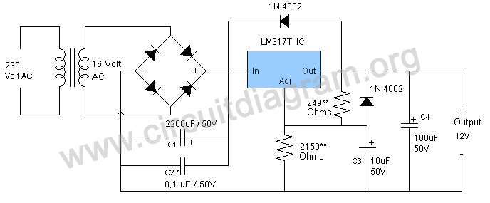

Hi
I consider replacing a 12 V switch mode PSU for my DAC with a linear PSU which is generally recommended. There are many custom made units on the market but I want to try a DIY project based on the LM317 or LM1086ADJ.
On the attached circuit (which I more or less as a principle want to follow) the electrolytic before the regulater is the largest (2200 uF) and the one at the output is only 100uF.
Other circuits show it opposite situation in the sense that the cap before the regulator is small and at the output is eg 6800uF.
Which solution is best from an audio point of view?
Thanks for helping
Torben

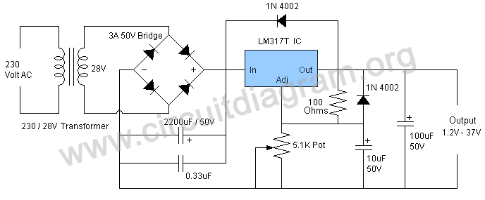

The shown circuit is ample. Too much capacity on the output and the regulation won't work correctly. Ripple on the input doesn't matter as the regulator will not see it.
28Vac secondary may damage the 317 regulator during start up and/or if you set output to 1.2Vdc.
The two capacitors will each determine the ripple and that ripple depends on the current you draw and how fast you change that current.
The 2200uF first and 100uF last is normal.
The 0u33F is not normal. Remove it.

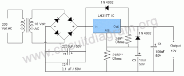

Thank you for commenting on the circuit. I have changed the drawing to show the exact values that will be implemented to fix the output voltage at 12 V which is the value that my DAC needs.
* C2 is supposed to be a 0,1 uF ceramic and should only be necessary if C1 is far from the LM317.
** the resistors are E96/1% metal film.
I understand that C4 must be a smaller capacity than C1 if the PSU is going to behave well without possible risks of malfunction.
Now for the core question: Many commercial PSUs made to replace switch mode PSUs for DACs boast huge values of capacity to be able to satisfy the need for
current. Is it then at the C1 position that the large capacitor bank is situated?
BR
Torben

It is conceivable that the huge capacitance is intended to satisfy the need for marketing.klitgt said:Many commercial PSUs made to replace switch mode PSUs for DACs boast huge values of capacity to be able to satisfy the need for current.
In any case, putting a huge capacitance at the output of a regulator rather misses the point of a regulator and may affect its feedback loop stability. If you really need a huge capacitance then maybe you need a low value resistor between the regulator and the cap to ensure that only the cap sees the audio, and the regulator doesn't see the cap.
then move C2 to beside the 317. At the IN pin and the bottom end of the adjust resistor string...............* C2 is supposed to be a 0,1 uF ceramic and should only be necessary if C1 is far from the LM317..............
Not beside the smoothing capacitor.
circuit shown in post #4 is correct. DF96 is correct too.
In operation you should monitor the output voltage with an O-scope, if any unusual current demands that the V regulator and 100uF output cap is unable to cope with should be visible. I see both Vadj pin and Vout has protection diodes present for caps there.
otherwise (very unlikely for DAC chips ) some extra bypass caps should be placed closer to the load to help those short term current demands. National (TI) and LinearTech have very good app notes discussing all of these subjects.
Basically Vin > Vout +3V under all conditions of line and load.
the higher Vin is, puts more thermal loading on 3 terminal devices. So selection of transformer and largest cap (Vripple) is key
