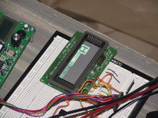

I finally got the Noritake VFD working. It sure has a lot of features.
Here is a pic:
Brian

Nice!
Farnell have just started to stock the new range - they appear on the website, but my nearly-new catalogue doesn't show them. Check out this page for details of the new stuff...
I'm especially interested in 412-875 because I think I can install it in place of my 20 by 2 text display in my preamp. And it's only £37 - just a few pounds more than the text-only unit...
Brian, I see from the datasheet that this display has the same interface as the text modules. But, do you know if it will work in 4-bit mode?
I hope it does because that will save me having to modify my PCB. If not, I've got enough spare ports on the PIC, but it would be a shame to be cutting tracks 🙂
I saw the farnell ones on the site, but I did not see that one that I got. The one that I got supports parallel, sync. serial and async. serial. The one that I found on farnell looks like the same vfd, but only with a parallel interface. As for the 4bit, I am not exactly sure yet. I will ask my roommate, as he is the one who configured the vfd to work for me.
