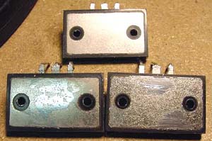

Lets make sure we are talking about the same thing as well. a MT-200 device looks like this:
