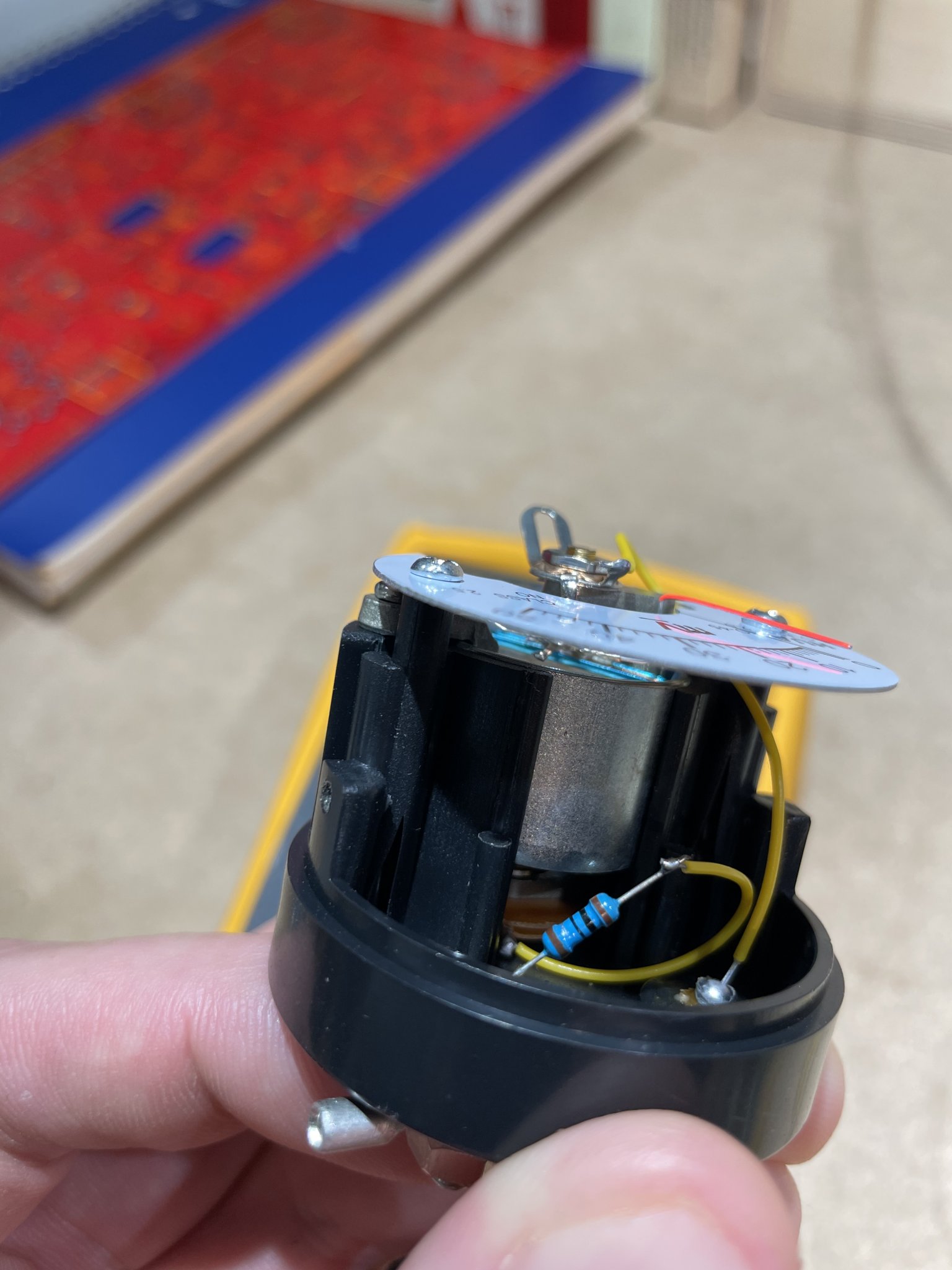

Ok the meters arrived from China today. I feel stupid but I can't get them to work....
I set my benchtop PSU to 4V
I put together a 4K7 + 47R voltage divider. I measured across the 47R and I get 0.04V on my Fluke DMM.
I clip the new analog meter across the 47R and it barely moves the needle (moves from 0 to 2mV). Does not read 40mV on its little panel.
Am I missing something or are these meters DOA????

Clip the meter AND the fluke across the 47r & see if they read the same.
The meter may be loading your voltage divider.
Measure the current drawn by the meter at full scale.

My point about the analog meters measuring 3 ohms was that aren’t voltmeters supposed to be high impedance devices? They are placed in parallel in circuits, you want high impedance so they don’t load down a circuit.
When I place the analog meter and Fluke DMM across the 47 ohm resistor I get no reading on the Fluke DMM.
I’m guessing the analog meter being 3 ohms is essentially shorting out the 47 ohm resistor. Not going to measure much voltage across a short….

As you've nothing to loose, can you get inside one & see if there is a shunt that you can mess with?

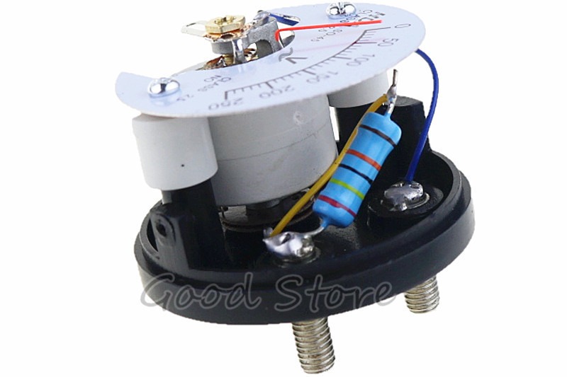

This type of analog meters are a current meter (milli- or microampere range) with a series resistor when used as voltmeter, a parallel shunt for the amperometer, or a diode/resistor for the vu-meter. It is easy to remove the resistor and use an external one according to the application. The built-in resistor is not a precision part anyway and may even be the wrong type. After removing the resistor, a protection diode may be added between the terminals if required.
Based on the 1mA rule for full scale I added a 47R resistor
50mV/1mA = 50R
Even with a 47R resistor in series with the meter a 40mV voltage as measured by my Fluke DMM only appeared as 20mV on the analog meter. The eBay seller has already refunded me.
