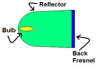

I have a question about reflectors. Why not build a reflector that is spherical in the back (or elliptical) and then the reflector continues all the way to the back fresnel?
There would be heating issues I figured. But this would cause most of the light to go to the fresnel, wouldn't it? Maybe leave a little space between the fresnel and the end of the reflector hood for air to get in and then have a hole in the back to suck air past the bulb.
Because "most of the light go to the fresnel" is not what we're looking for. We are trying to get a point light source and have all rays go from that source through the fresnel and then to the projection lens. It's not enough to have the rays bouncing at crazy angles before they reach the LCD. The image would be worse than a plain bulb with no reflector at all, because the contrast would be bad and there would be blurring and possibly multiple images.

The idea is to get most of that light through the lens and onto the screen. A point source with a condensor fresnel to make a parallel beam the size of the LCD, and another fresnel to focus that into the projection lens is one way to do that.
But there are other ways that work. The method closest to "big reflector all the way to the LCD", is a custom parabolic reflector making a big parallel beam that gets focussed into the projection lens by a field fresnel. If you have the right curve and the lamp arc in the right position, then that would work pretty well with just one slight problem: You might see a bright spot in the middle of the screen from the direct light. One solution is to add a tiny spherical reflector right up against the front of the lamp arc. That would send all of the direct light back through the arc and to the parabolic reflector.

If you want to use a condensor fresnel, then it has to "see" the light as all coming from a point source. You can do that with a spherical reflector or an elliptical reflector, and there are plenty of discussions of exactly how those work on this forum. (see Lighting section) Either one can work with or without a pre-condensor lens.
Any light that comes from somewhere other than that point source, will be refracted by the fresnels so it doesn't get to the projector lens. So it ends up being useless heat in your projector or "fogging" your image.
You also need to send a significant amount of cooling air around the MH lamp to keep things down to a reasonable temperature. Sealing a lamp inside a reflector would make a terrific oven, but would not do anything to get you more light going in a useful direction.
If you want to design a custom reflector, then make it elliptical with a curve to match an available fresnel. You won't need a pre-condensor lens if you do it right, and it will get lots of light to the LCD.
