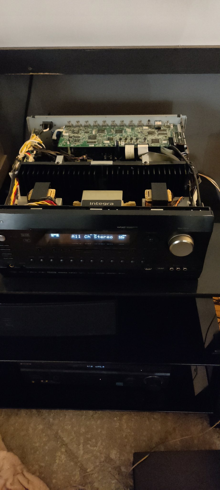

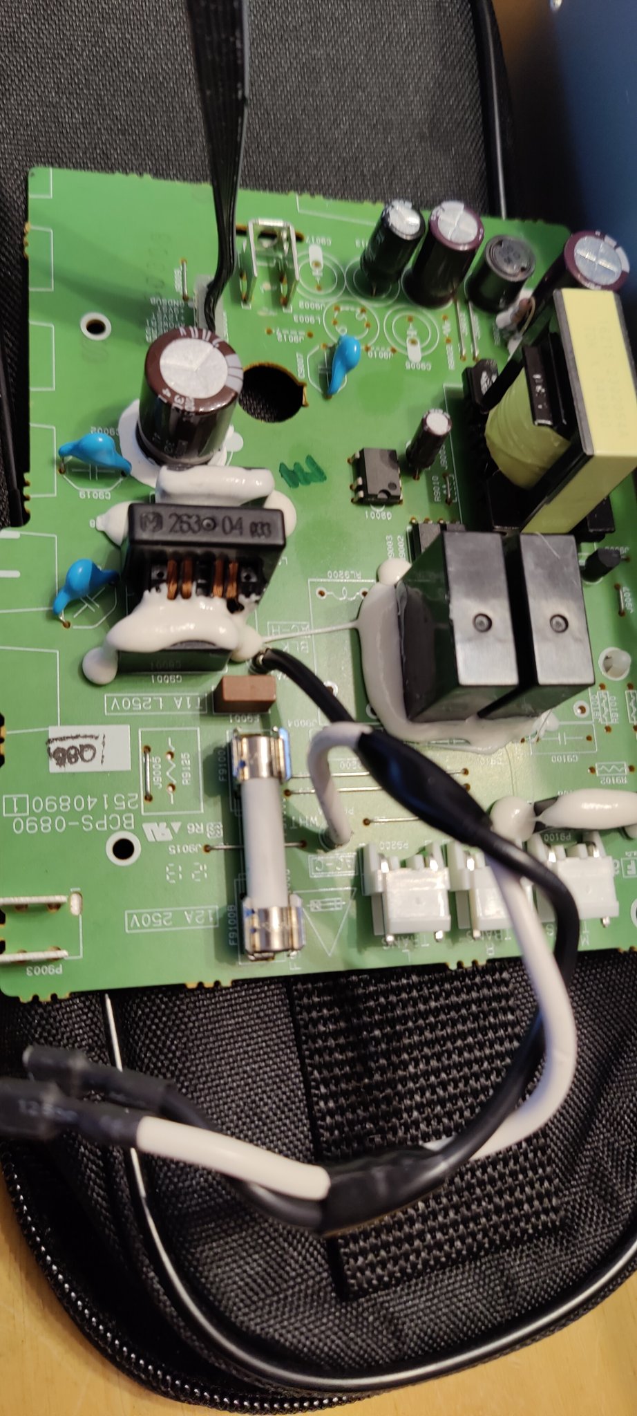

I have an Integra DTR 70.4 with no power. The relay coils are shorted, and the voltage across them are 5x what they should be.
Your thoughts?
I'm thinking an electrolytic went bad in the high heat Integra is notorious for.
I can try to fix the board, or just replace it, but I can't find it anywhere. Your wisdom is appreciated.
Thr to ignore the silicon job. It was that way when I bought it.
Update: replaced the relays and a couple caps, voltages are back to normal, receiver is back to full operation and sounds AMAZING! Pretty stoked.
Might add some cooling. A liquid cooled receiver seems a bit much, but might do it just for fun.
