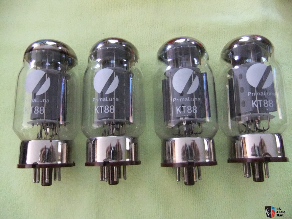

One of the four valves of my Prima Luna amplifier is failing, I would like to buy only one because the rest do not have much use. Anyone know where to buy them in the USA ?
They are KT-88, with the PL logo stamped by the factory, but are in actually manufactured by Shuguang from China.

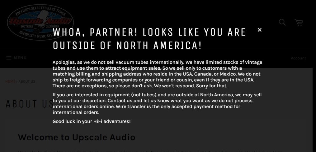

How about Upscale audio
They only have EL-34 with Prima Luna's seal.

I have 4 x EL34 Electro Harmonix and 4 x KT-88 Sovtek

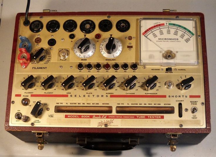

But, I have 3 original tubes (Shuguang-Prima Luna) with 80% remaining life, measured with Hickok tester.
More sound to my taste than Sovtek, I just want to complete the set original KT-88 Prima Luna

Furthermore, the hitchkock testers are in no means parametric testers or tube analyzers, 80% remaining life is a guestimate made by this tester. Based on mostly calculated values. Your shuguang tubes might have measured 100 to 180mA Anode current from the factory. (140 is the middle on the mean distribution if the manufacturer is any good)
The Hichkock is a transconductance tester, that uses poorly regulated voltages. It will achieve a high degree of relative accuracy. Wheras true parametric testers that use regulated voltages and good meters will achieve a high degree of absolute accuracy. Examples of this are the Metrix U61 and Neuberger RMP370/375 (Wheras the latter use rather poorly regulated anode and screen grid voltages, which necessitates adjustment every time a tube draws more or less current. )
The only way for sure to estimate remaining life on an output tube. Is by measuring them directly after burn in at a fixed set of parameters. And then re-measuring them at 500 or 1000 hours intervals.. from this you can extrapolete when the cathode is worn out or when the mu/transconductance drops below a useable level. (Most current production tubes go gassy or short out before the cathode goes...)
Most if not all SQ tubes made by Philips or Telefunken had their end of life specifications well written out in a datasheet, most consumer grade tubes never had any published Min-max readings for the anode current and transconductance these tubes where manufactured to in-house standards. Whereas for example a E88CC was guaranteed to have an anode current and a transconductance in a specified range fresh from the factory box..

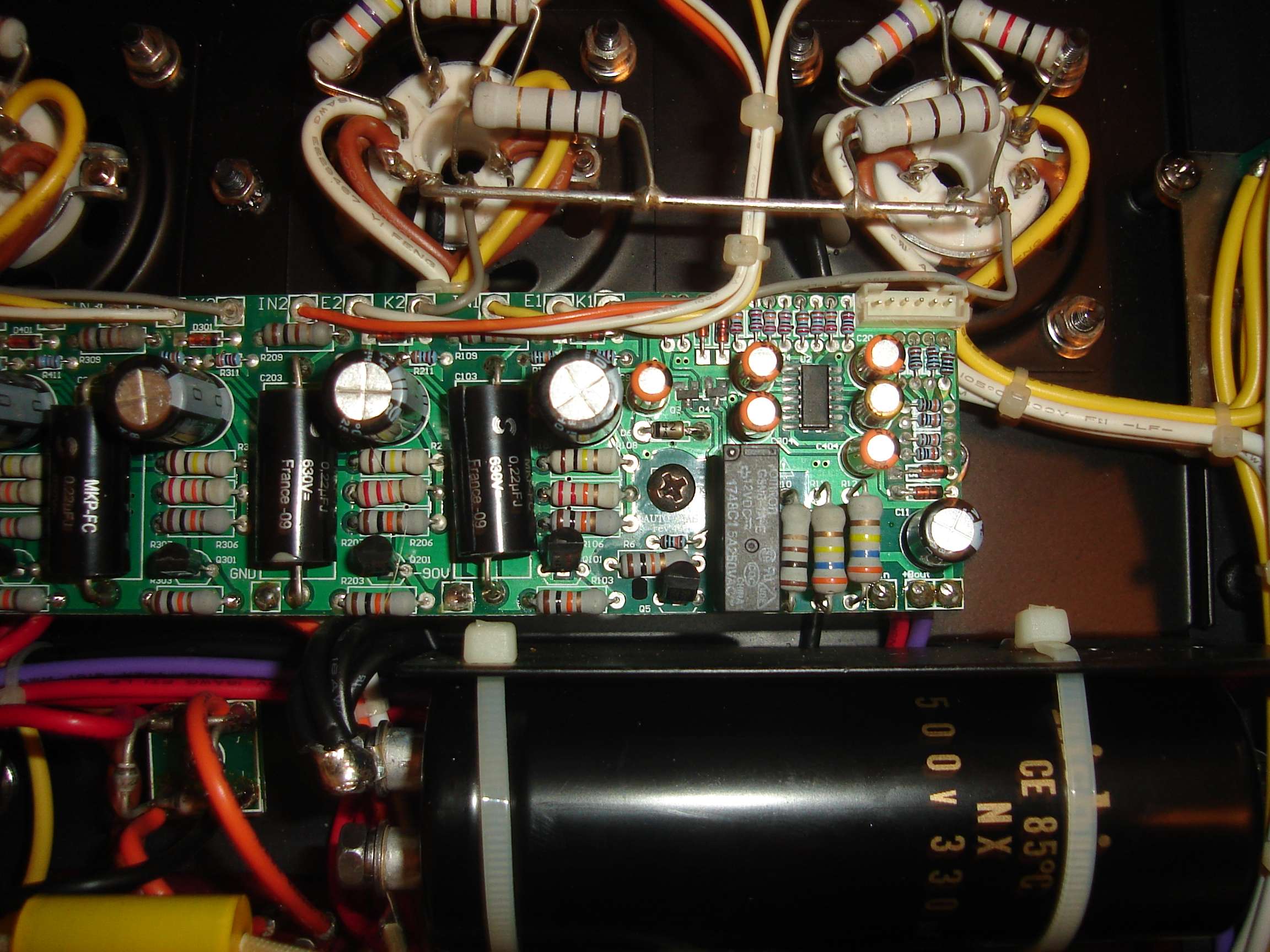

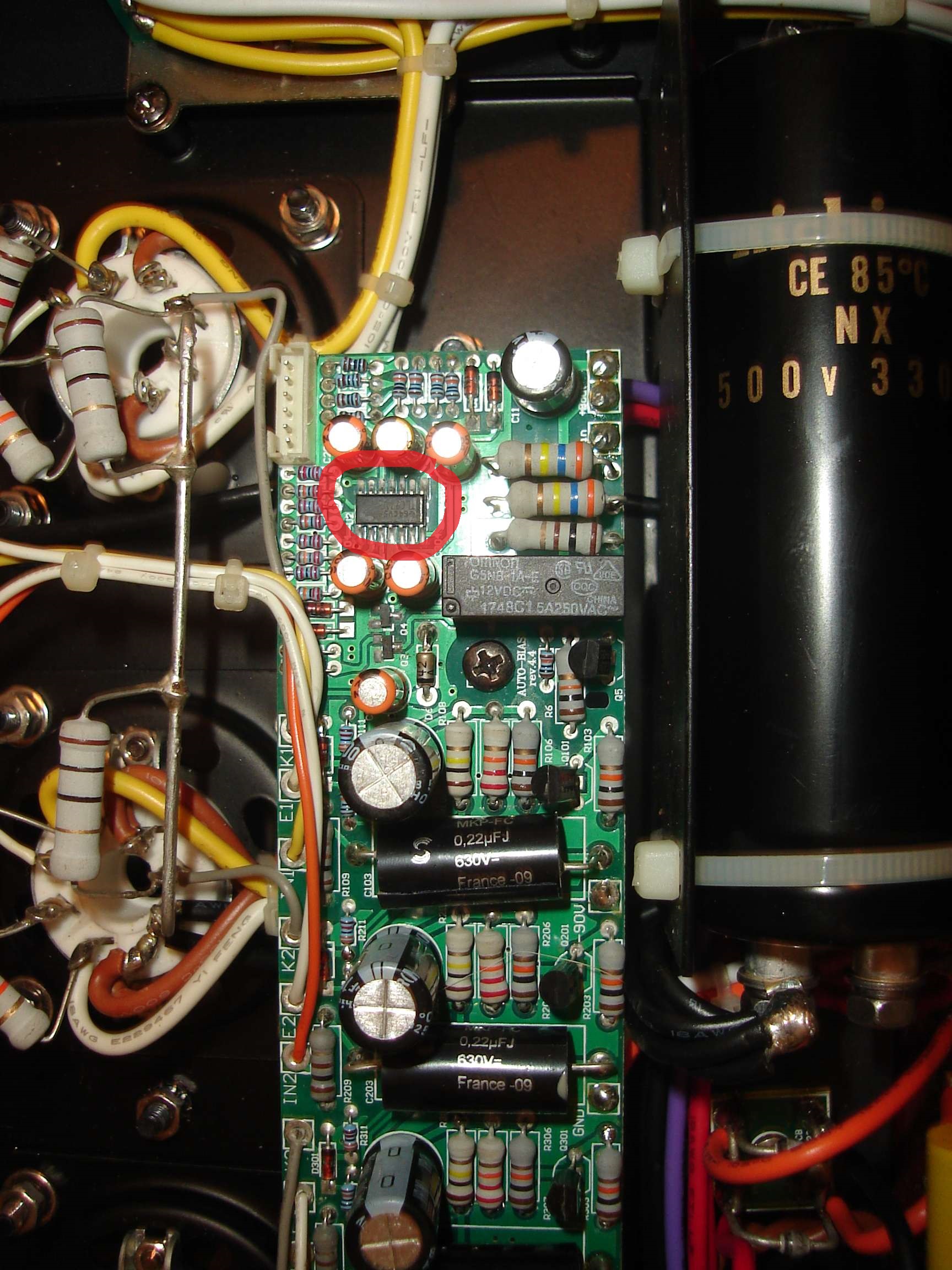

On one occasion I replaced the common fuses with the audiophile 😎 Little Fuses and took some pictures of the Dialogue Two Autobias.
Here is the operational amplifier, I can not see its denomination...
Anyone know? Just to know, I forgot to take note at that time...
Thanks in advance 🙂

Well in higher end products you pay for the Brand not the product..
The primaluna's are much better then most of the Chinese amplifiers, their layout is good. However Shelling out a few hundred more for a bias servo PCB that costs them maybe 25Us to install is madness in my opinion.
I am not going to link to their circuit to avoid any trouble altogether. However suffice to say it is a very basic analog circuit.. That comes with its own set of drawbacks..
