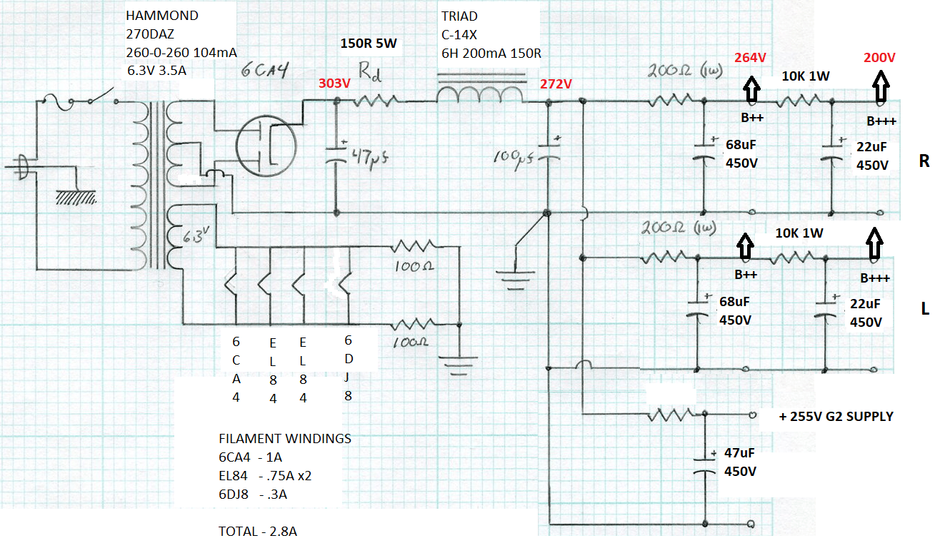

Hey, thanks for taking a look. Should have posted a schematic, but I don't have an up to date one and I'm stuck at work.
Anywho, it is a CLC power supply. I am familiar with PSUD, but not expert. Not sure how to set it up to correctly model the circuit. But I don't think PSUD's model includes any part of the circuit beyond the tubes, and the power consumed by the power tube's cathode resistors is what I'm really asking about here. I've built an amp with an over-rated PT, but this one is right at the ratings and I'm wondering if those big resistors might put me over the top. Of course, Hammond brags that their PTs are under-rated, so maybe it's nothing.

Old schematic. I've removed that 150R resistor in front of the choke.
B+ is now 308
B++ is 294
275 on plates
8.5 on cathodes
B+ is now 308
B++ is 294
275 on plates
8.5 on cathodes

What exactly are you trying to figure out? I think you may be confusing different concepts.
You said you already know the DC current drawn by the tubes -that tells you the total current for the amplifier. Multiply that DC number by about 1.6 to get the total AC current the transformer has to supply. Adding series resistors or chokes into the power supply does not increase the load on the transformer, in fact they reduce it because they 'restrict' the current a little more!

A very useful modification puts the 10R resister in the negative lead to the PT CT.Replace Rd with a 10 ohm resistor. Measure the voltage drop across the resistor. From the voltage drop use Ohm's law to determine the current draw of the entire amplifier.
That makes checking voltage drop much safer. And a good place to check peak current
into the first cap you can see with a scope, At that point the current needs a RMS
responding meter, these daze most DVMs are. 👍
Move the 150R ( or 100R ) current sampling resister to the negative return lead to the PT CT. Use a 2W resister.I had that 150R resistor in front of the choke,
The first cap after the rectifier is better at 22 microF, less stress on the PT.
Not only does that work well but it is a safety feature if you intend to use this amp as a teaching tool.
The Hammond 270DAZ will be short lived in this circuit, there is no capacity to allow for RMS currents in the HV windings.👎
The PT is not hot to the touch, but maybe if I was running it louder...But yes, the amp is a teaching tool for the DIY club. I've removed the 150R resistor and increased the K resistors to 200R, tubes now running ~42mA so hopefully low enough to keep the PT happy

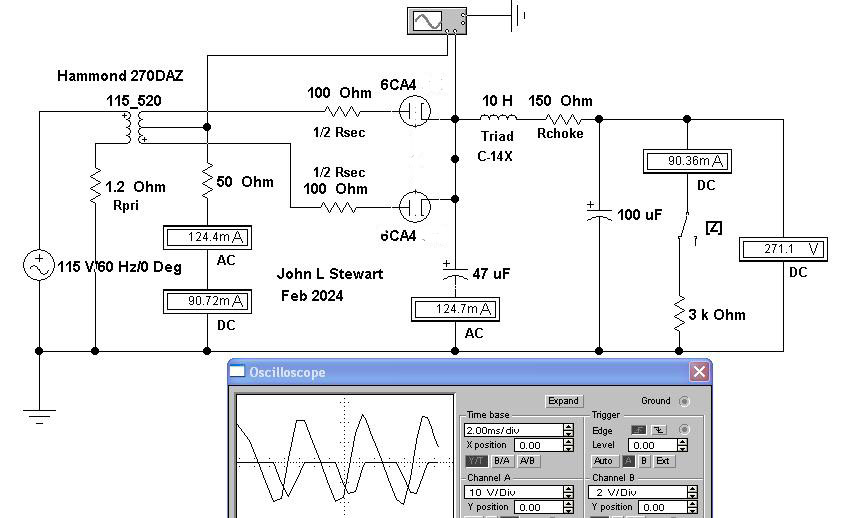

I ran an Electronics Workbench simulation of the circuit on page 5. are the voltages on your schematic actual measured?
In the Sim there are both AC & DC ammeters in the negative return lead to the PT HV CT.
If we do 'root of sum of squares' the RMS current thru the PT & rectifier is 154 mA.
The DC component goes thu the load. the AC component thru the 47 microF cap & back thru the PT & rectifier.
Pls measure the DC resistance of each half of the PT HV winding, I'll put that in the Sim. THX
