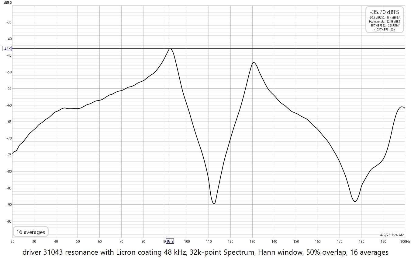

I don't know what sort of speakers you are building, but if you need to tension the mylar film, I have a tensioner design that I just used to successfully restore a pair of Quad ESL-63s. It's a variation of a tensioner I developed in the 80s when I started building ESLs. The tensioner allows on the fly tuning of the resonance of the film before gluing to a frame. It's an MDF/wood rectangle with a bicycle tire tube stretcher over it. There is double stick tape on the underside. You lay the film on it, and stick it to the tape on the underside, then inflate the tube which tensions the film and eliminates wrinkles.

I test resonance by bouncing a ball bearing against the film and capturing the sound with a UMIK-1 mic. The mic plugs into a laptop running REW. The RTA in REW provides the spectrum of the sound made by the ball bouncing on the film. You can adjust the resonance by tweaking the air pressure in the tube.

Here's a typical resonance plot for a new diaphragm on a Quad driver:

I tested factory diaphragms before replacing them (the stators under them had come unglued and the only good way to reglue them was to destroy the diaphragms), and set the resonance of the new diaphragms slightly higher in primary resonance. When you get the resonance you want, apply glue (3M 4693H) to the film and the frame, wait 20 minutes for the glue to set, then put the frame down on the film.
4693H is contact cement formulated to bond to low surface energy plastics like polyester. It forms a strong bond with the film and doesn't creep due to the film tension. I have some drivers I worked on around 2005 and they are still bonded. Here is an example of the bond:
If you're making electrostatic speakers, Licron Crystal antistatic coating on the film gives 10^8-10^9 Ohms/square. Those 2005 drivers (with Licron, before Licron Crystal was available) still read 10^8-10^9. It takes only seconds to apply and it bonds with the polyester.
