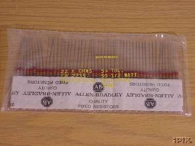

Thank you for the suggest, I have contact http://www.welbornelabs.com before but all they got is 10% tolerance but I need the 5% tolerance.
Hi Apex Jr and MRehorst,
Do you have any 5% tolerance in stock ? I need some values like
1/2W 5% tolerance 68, 3.3K, 10K, 22K, 27K, 30K, 56K, 100K, 200K, 220K, 250K, 1M, 2.2M.
1W 5% tolerance 18K, 2.7K, 51K, 56K, 100K, 150K.
2W 5% tolerance 12K.
I need 25 or 50 pcs for each values, are they in the original AB package like this ? can you give me a email please ? Thank you very much.

Sent private email letting you know stock.
forgot to mention some come in the distributer packs
and some will be bulk. The small quanity I quoted you
were bulk, for sure. The 22K 1/2W are in a 1000
box in trays. FYI
Steve
