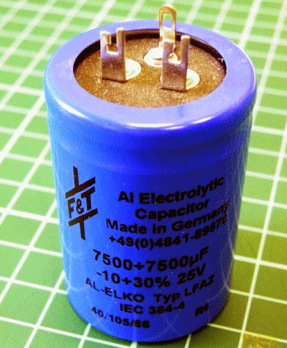

Was having a bit of a rummage through some out-of-date electrolytics, and came across a few of these:
(see pic)
They're 7500uF + 7500uF dual section electrolytics @ 25V
I've dug around, and apart from one uninformative catalogue reference and one Google hit on someone selling some NOS ITT parts of the same value, I can't find out anything about what equipment they were originally used in.
The ones I found were from 2003, so there must have been some ongoing use for them.....
Someone must know....!!!
Any information gratefully received.
Matt

These dual section electro"s are probably used in The Power supply of an amp or simular , they could also be used as the output caps in a lowish powered single ended amp , or really anywere you need a 7500uF electro....

i am guessing that the connections are two positive leads and one negative lead. if so it would probably be for a dual power supply, like a +12/+5V supply, or for a pi section filter with a choke between the two positive terminals, the power supply on one side and the load on the other.
hmm, high power power supply's, i have seen stuff up to 20.000uF in an 12V power supply.
class A amp's of 10~20 watts normally need 20V and -20V, maybe from something like that.
so anything that needs high current and a low voltage.
Thanks chaps - really interesting responses.
One further question:
Does anyone actually design in high uF/low voltage dual sections like these anymore (apart from for neatness when replacing one in an old PSU)?

Afaik, Fischer & Tausche used to be the only remaining manufacturer of low voltage dual section electrolytics on this (in)continent in 1K9.
Their LFAX is a general use 105C type, mainly to save space, same goes for the higher voltage LFAZ range.
Electrolytics have become much smaller, no use for duallies i suppose.
