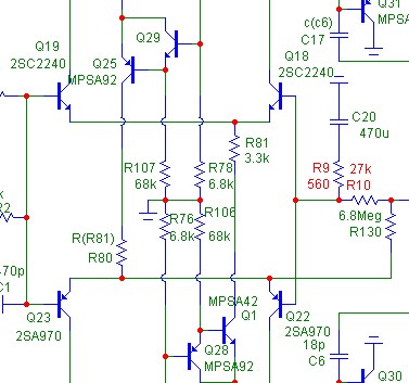

Hi Andrew,
It is difficult to generate only certain orders of harmonics but I have found that one can push the even order harmonics to be higher than odd orders by a tiny little "feed-forward" from output to LPT emitter, values in the Mega Ohm should be used.

Andrew,
I first saw John do this in patch work and only after modifying it a little I noticed this. I am not sure if John did this intentionally or whether it was a sort of bootstrap.
It does not lower other harmonics it but increases H2 by whatever amount you want.
Nico
