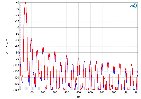

i listen only to digital sources these days So my guess is that -100dB can be quite achievable by dacs
Some power amps instead are more challenged in getting low distortion figures
I read that someone speak highly of amps with a distortion spectrum far from unreprochable
https://www.stereophile.com/images/222Dar1082fig08.jpg
Perhaps we have an idealized idea of hi-fi and its purpose. But hi-fi devices and loudspeakers are also musical instruments that can be in tune or out of tune, which cannot be captured by the usual "distortions". It is, for example, about material resonances and their composition.
Loudspeakers are a mechanical example. If I place LS on wood or steel or aluminum or stone or rubber, the audibly tuning will be different every time. However, it will not be possible to detect this with the usual current peep measurement methods. And if it is, then it will not be easy to translate into hearing measurement methods.
