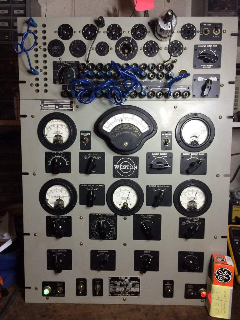

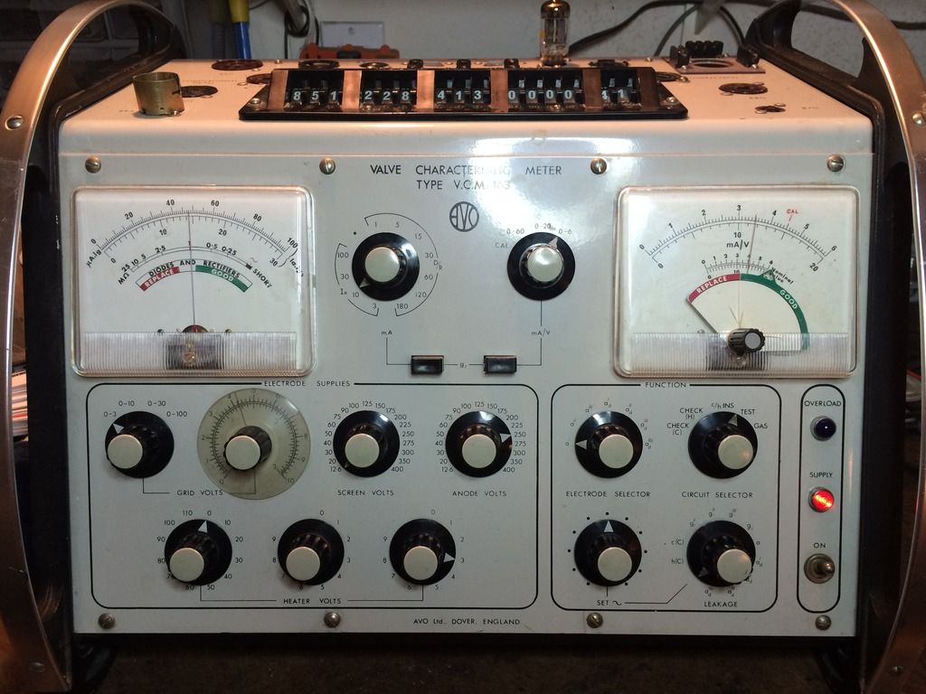

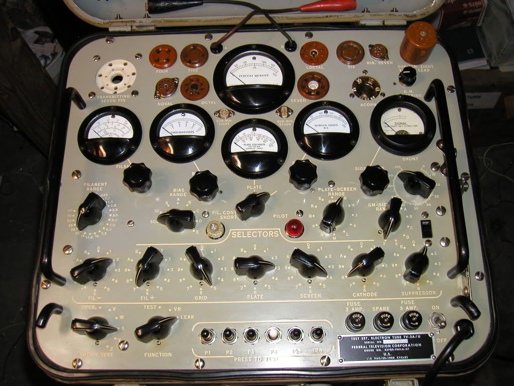

These are my tube testers that I use...I have rebuilt, modified and calibrated all these testers better than factory spec..Describe your testers and/or the circuit the 12ax7 are running in. Are these testers, amps? How are you setting up the voltages and loads and K bypassing?

Some nice machinery. Have you had a chance to burn any of those in for 10-20 hrs. to see if they settle down any? I guess if you put them in a circuit designed to run a bogey tube then you'd have to check their drivability in and out, in the circuit, to see if they can do what's expected without tweaks for accomodation.
I test lots of tubes on my Avo, and when I find one that measures suspiciously high in gm/Ia, I immediately check for presence of gas.

I've tested 100 pc 'master pack' from '70's Siemens each tube through AVO tester and it followed the Bell Curve. The tubes I value most are the ones between the two shoulders of that curve. Too strong or too week simply dont bias the same, simple as that.. as a DIY type you can make adjustments, but the tube is out of spec.

Hi Chris,
I have a TV/2U like yours that is unrestored so far. Yours is in far better condition than mine, but I can say that all the meters and sockets appear to be intact. It's bugging me to do it, always in the back of my mind. Can you share any information or pictures of yours in various areas? I'll need the references when I dive into mine.
Please PM me so I don't clutter up this thread.
-Chris

My Website goes into detail about the problems with the TV2 and the remedies...
I can send you photos of the rebuild ....
Go to this page and scroll down to the TV2...

When I test tubes, I use these instruments :
If I need to measure tubes (that is to say with more accuracy), I use a small bench test :
And yes, like you I find tubes "under" and "over" specs about the plate current, regarding the datasheets.
But I remember that RCA states in their manuals that the performance of a tube can be accepted within a margin of -30% to +30% about the plate current. Outside that range, the tube should be compulsorily discarded and considered defective.
This is the rule that I apply when using my Metrix 310CTR tube tester. This instrument is able to test the tube under its true nominal datasheet conditions, which is taken as the reference, unlike the Hickok and many other tube testers with proprietary tube charts.
Of course, in that margin, some tubes will work better than other, or even not work properly, depending on the criticity of circuits where they are installed.
Too high plate current may also reveal leaks, gas, grid current - even in the -30 / +30 margin, so complementary checks must be performed if the tube application is critical.
