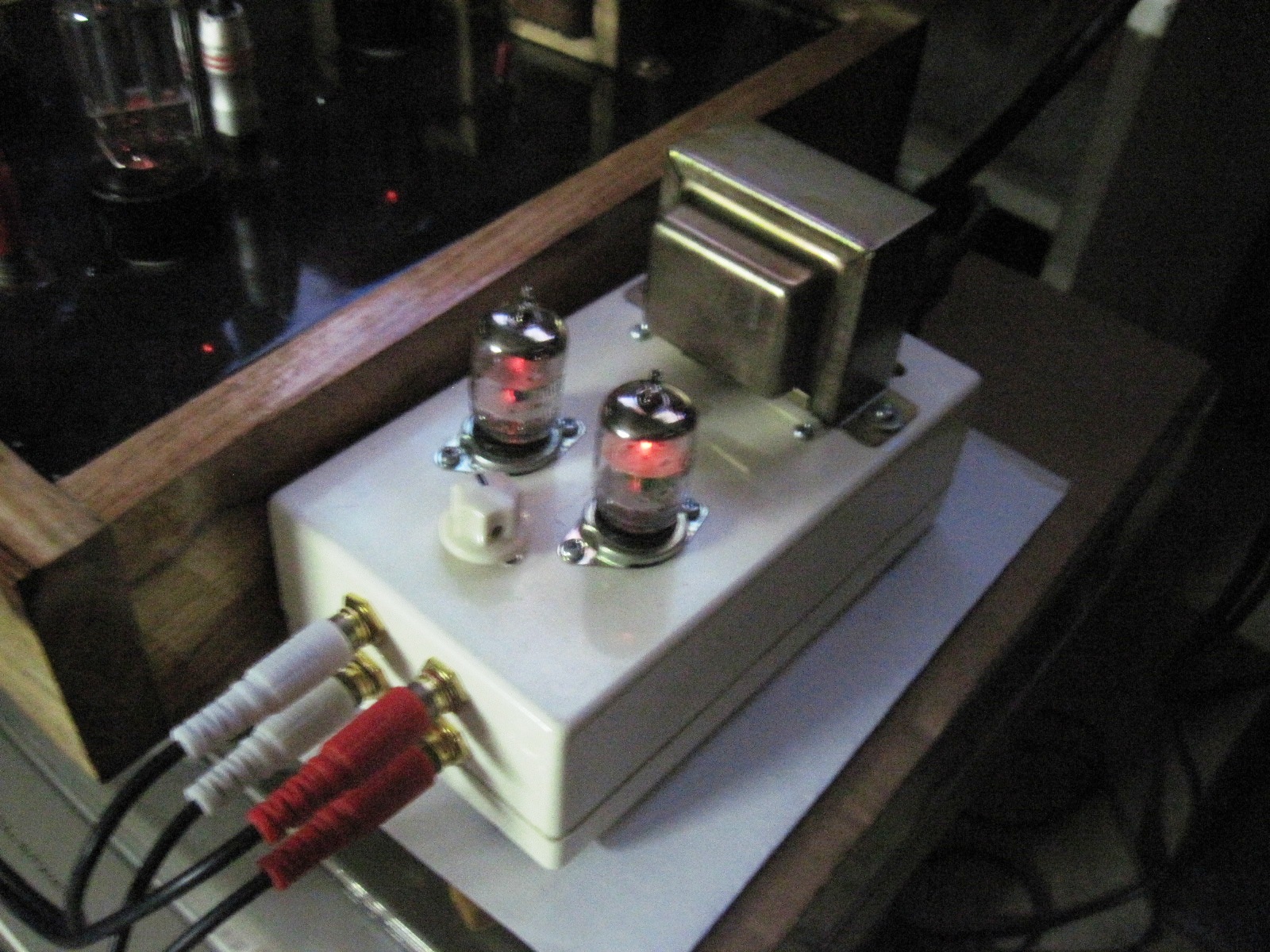

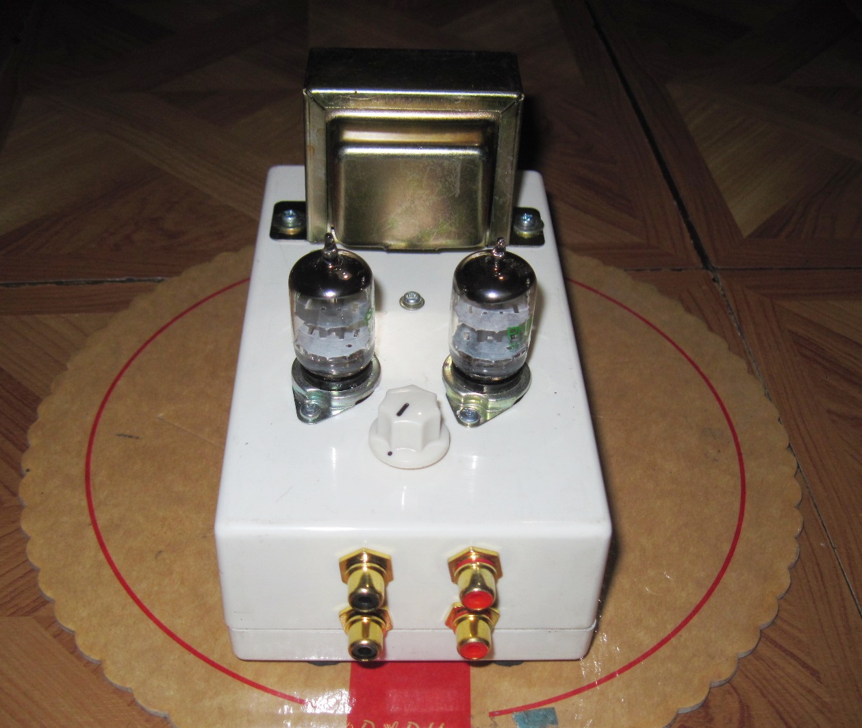

you will know you have done it correctly by the amp you make.....
i made a common cathode line amp on a plastic enclosure
that is very quiet as quiet can be....
sure we can talk about it day in day out.....but you still have to make something....

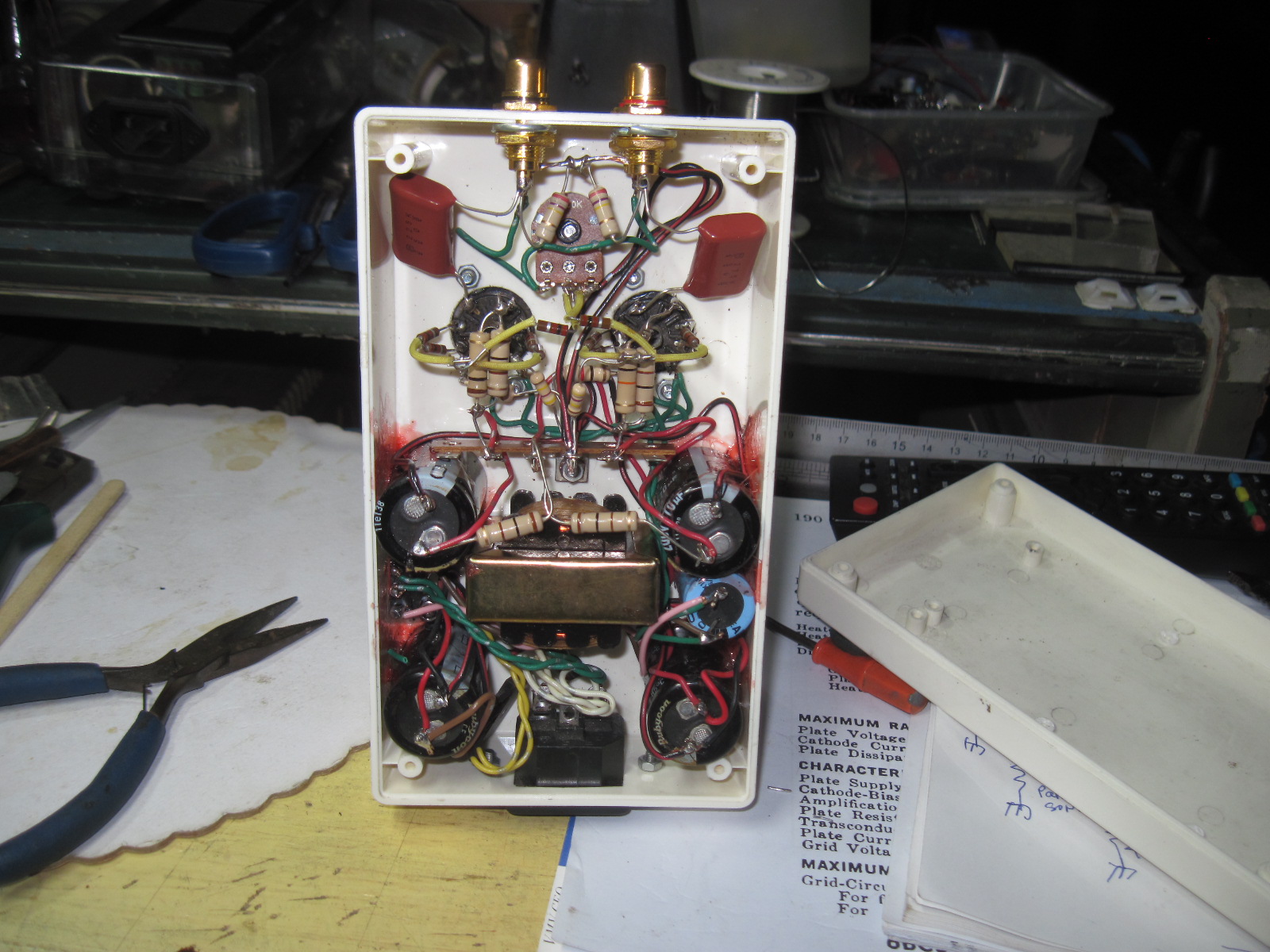

AJT, your caps are bleeding 🙂
ahhh, those are "rugby" rubber cement used to fix the caps in place.....
