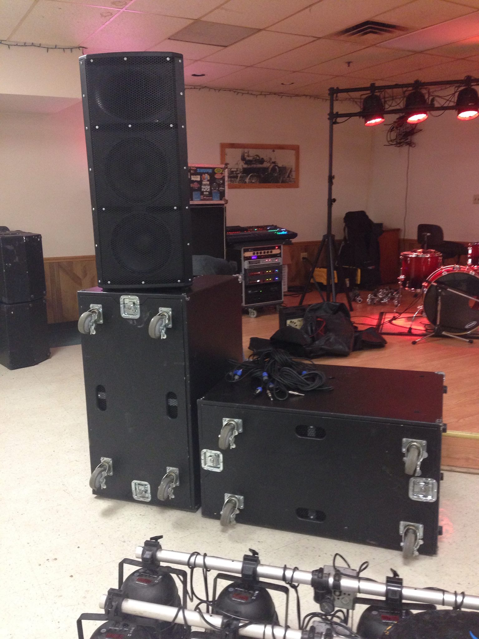

Time is getting closer for my 18s and 24s to arrive
Question one...
How to keep wheels from rattling when mounted on the backs of my double 18s and single 24 cabinet. .

Q1 :rubber door stoppers or wood wedges (always kept a good stock of those in an old milk crate in the truck)the other way to go is install removable skids with the wheels on them (crafty planning can help with queston 2)

most removable casters are for the most part too small or flimsy for cab use.(and get lost just before load out)
with wedges and casters in some cases i'd use a wedge between the wheel and frame and put another between it and the box to stop the swivel bearings from adding there maraca accompaniment to bass notes.

the removable skid idea does dual duty no wedges required and keeps your grills clean and damage free
I think by skid you mean what I call a wheel board. harbor freight sells them cheap, or make one:
Roll the speaker in on one, then lift the speaker to the floor. Now the wheels won't rattle, plus you can use them for another cab or other large thing moving in from the truck.

As far a question one is concerned, invest in high quality casters--the type with greaseable axles and swivels--and keep them well greased. A solid cabinet design also does wonders for keeping rattling to a minimum as I've never heard the casters on any d&B subs rattle.

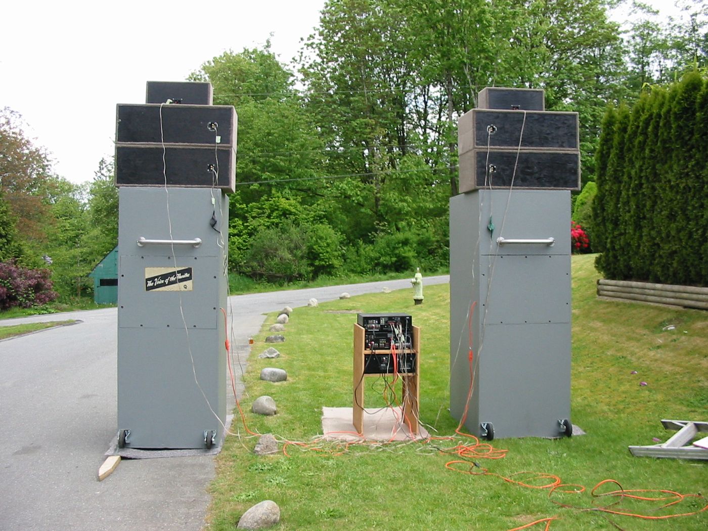

I turned mine into a hand truck, with the wheels just high enough to engage when the box was tilted back with the grab bar. That way I could keep the weight over the wheels which is important when the cabs get big. Hard to tell but those are 6" industrial wheels.

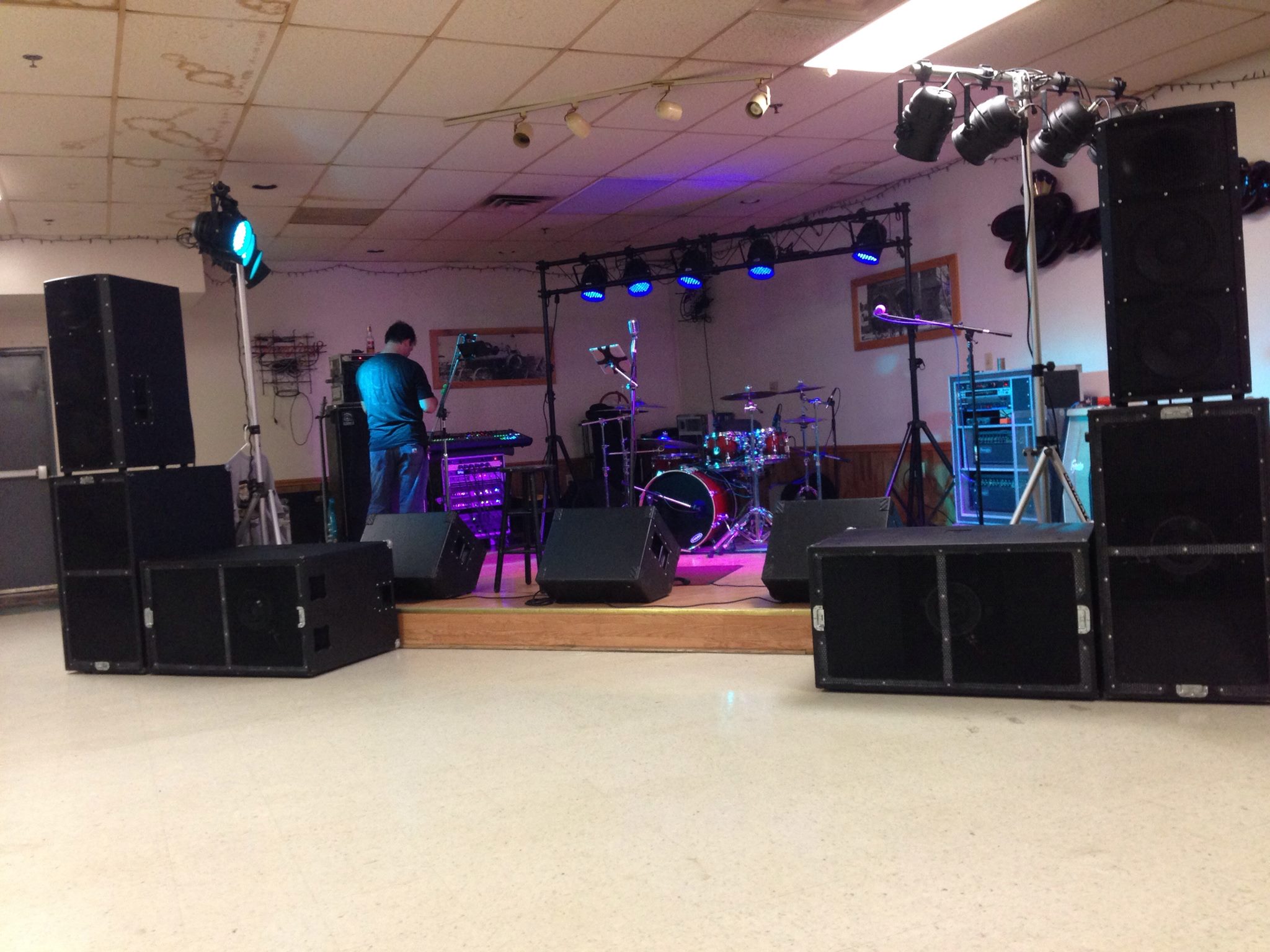

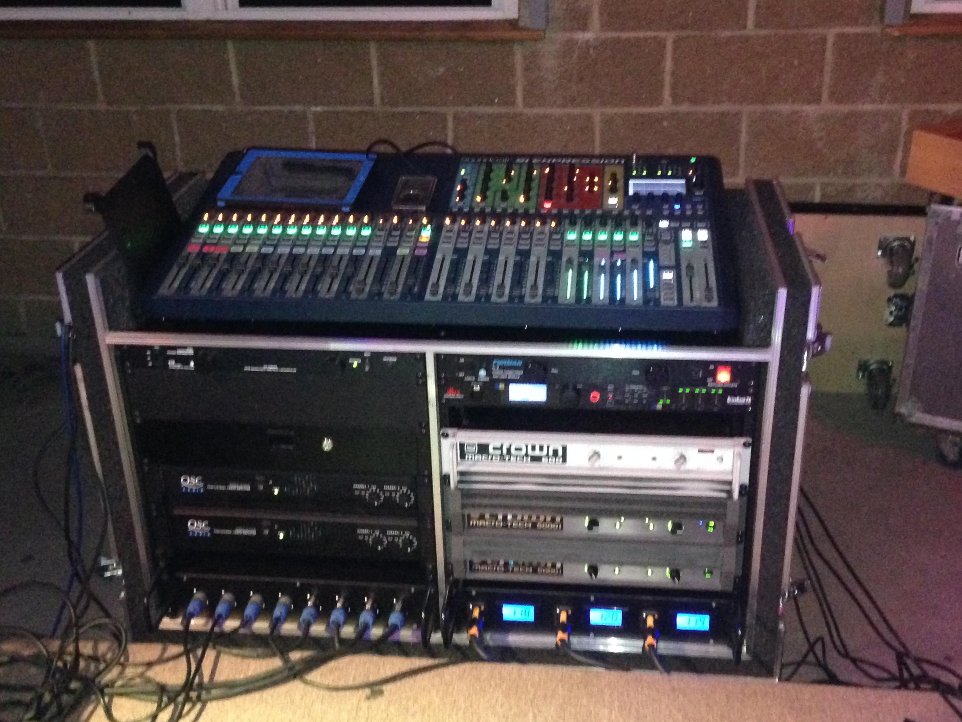

Thanks guys. Yeah, I am using a Crown MA9000i on the lows, MA5000i on the mids, and MA600 on the highs. system sounds clean and clear through the soundcraft expression.
the cabinets took a while to complete between assemble and saving money for drivers. the subs use 18 sound 18LW2400s. the upper boxes use 2 eminence delt pro 12s and Faital Pro HF146 on a Faital Pro LTH142 horn.

I love it. however, it's the only digital board I have experience with so I don't have anything to compare it to besides my old Yamaha analog. going from the Yamaha to the expression was really easy. I learned the basics and figured out more advanced features as I needed them. I only use a small portion of the features, but that is all I need.
