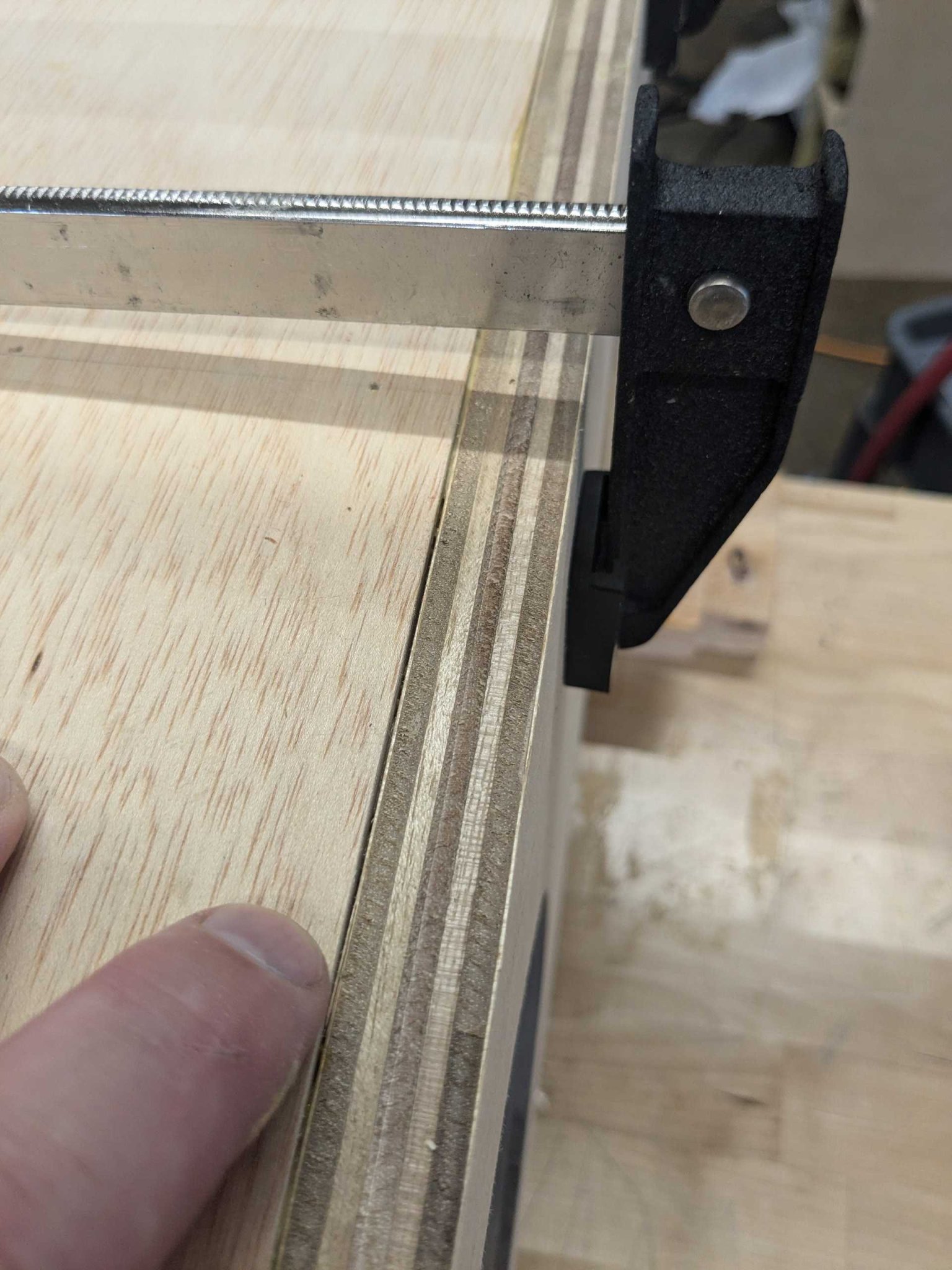

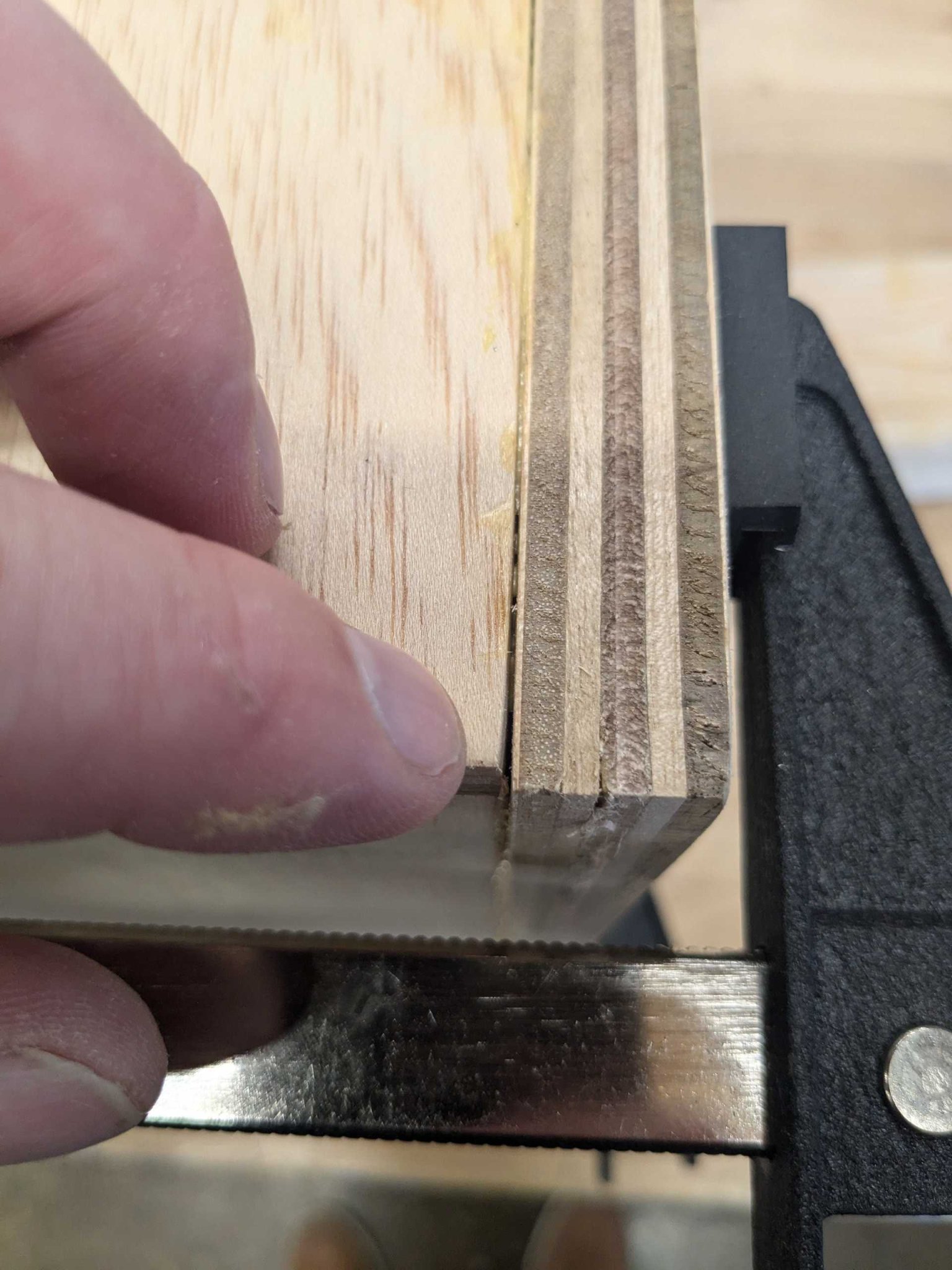

What has everyone come up with for filling the tiny spaces you see in these pictures?
I have been just filling it with putty but the issue is that sometimes the stain doesn't quite take right in that area.
I am considering mixing the putty with some of the stain to hopefully blend it buuutttt, that might just double stain that particular area and make it way worse.

In the past I've used sawdust from cutting or sanding the wood mixed with enough PVA to bond. I guess you could mix some stain withe the dust and PVA???

I have showing plywood end grain. It's ugly. Doesn't take stain right. Doesn't last. I plan my builds to minimize it. How much more expensive is solid wood? If it's just too much, consider a cap of matching real wood, maybe 1/4"-1/8" thick, glued to the edge. They make tape for this too, with matching grain, but it's not very durable. Depends on your usage.
Oh you're talking about those tiny gaps. Heh.
Get some sawdust, mix it with your wood glue and shove it into those gaps, jam it in with your fingertips, rub til smooth. Wipe with a damp cloth before the glue dries so it won't show under your stain.
Fine sawdust/wood flour works well but imo is best when used in conjunction with dark stains as the adhesive geneally darkens the mixture. This is just my experience and perhaps binders/adheisives I haven't tried work differently. It cost nothing and takes very little time to make up several test samples, varying adhesives and sawdust if you're so inclined. Sawdust from a lighter colored wood may make a better match.

Here I'd use hardwood strapping to cover that, but I hate to spend that amount of money so only for my "better" builds
You could maybe avoid gaps alltogether by sanding the "open box" perfectly straight?

Water based wood filler. Takes stain well, cleans up with a damp cloth to minimize sanding. All the same, avoid getting any on the plywood edge grain (mask it off with tape) as it will show no matter what. Water based filler can shrink and crack if you don't apply it in layers when the gaps are too large, also if the joint moves. Integrity will improve when the finish is applied.

If I cant add more glue and clamp it down, I have been either:
1) filling with 5 min epoxy for deeper holes, leaving a bit of a gap at the top to sand and add #2 below
2) making a paste of Titebond Red or good ole PVA wood glue and saw dust to fill in cosmetic gaps. This should be stainable.
With 5 min epoxy tho....dont mix with sawdust before applying. I tried that. Got real hot real fast and fluffed up like pancake mix.
