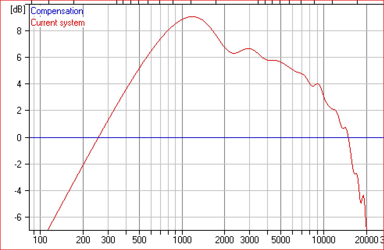

If you want to save sawdust use physics. The physics of OB is simple wave mechanics. Even simpler is to use a program that does the maths for you:
Home of the Edge
Edge is easy to use, free and lets you see what happens to the output with different baffle sizes etc
If your FR driver is already in a 223mm diameter circular mounting frame it has its own baffle. If you just plug the mounting screw holes and suspend it then the frequency drop off with that minimal baffle is:
Home of the Edge
Thank you Kazap. This software helps me with the project!
