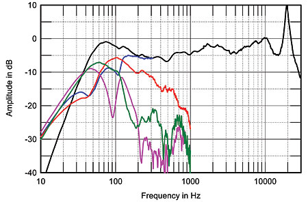

What does this mean exactly?Ron E's point about VC diameter is right too. Many inverted dome's that have typical oil-can resonances.
Hi Casull,
Not sure why it is called "oil-can" but in metal tweeters you'll see this as a severe peak, typically 10kHz or higher.
Often this peak vanishes off axis, so careful planning or turning of the speaker will resolve it. Here is a typical example from the Monitor Audio RS6. This speaker sounds much better than that peak would lea you to believe, note the 12 dB above average peak at 20kHz:
