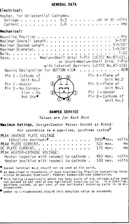

Working on a big guitar amp finally, big enough to need a GZ34.
I was wondering if there was a damper diode alternative to that? I know about the 6CD3/6CE3/6CG3, but these are only half wave, and 2 would need lots of heater current. I know about the 6BY5, but that's only good for 175mA I guess.

mashaffer said:Just for my edification what makes a damper diode different from any other vacuum diode?
Slow heat-up, low internal impedance (= low voltage drop), and a good heater/cathode isolation so you can use a common heater supply.

A damper diode (or efficiency diode in Europe) was used in TV in the horizontal output stage. The circuit was high voltage, high current, low pulse duration service.Just for my edification what makes a damper diode different from any other vacuum diode?

leadbelly said:Working on a big guitar amp finally, big enough to need a GZ34.
Dude,
The 6BY5 is good for 175 mA. continuous DC per plate. Carefully peruse the 6BY5 data sheet.

JoshK said:Does the 6by5 warm up slow?
Yes, very.

Tom Bavis said:6AX6? Good luck finding any... a pair of dampers would do as well.
Haven't seen one yet. Also, at 2.5A of 6.3, a pair of 6AX4 would be lighter on the heater current. 6DE4 only slightly heavier, and 6DW4 very much higher capacity than any single bottle pair.
