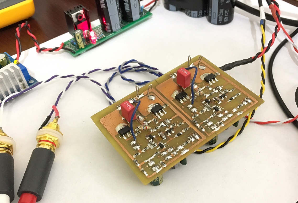

I use vero-board and SMD components. When I prototyped out "My Bridge Amp", more pics HERE. I Used 0603 or 0805 components and SOT-23. For the SOIC-14, I cut the pads around the holes in halve to meet up with the pin spacing. High reliable part density can be done by prototyping this way. I constructed an entire stereo using this method HERE using parts primarily that I scraped from junk. Using solder bridges from pad to pad to make the circuit traces, it is easy to change around the circuit routing.🙂 Also you can re-use the solder after the prototype ends up in the parts bin to use on the next prototype circuit you make. Plus, you can use jumper wires on the top side effectively giving you multiple layers. Any general standard through hole package will fit in these prototyping vero-boards and did I mention they are cheap?😀

Sharpie as resist on copper clad phenolic board. Can be cut with utility knife and ruler and and use SMT where possible. No drilling required for SMT.
For more complex layouts use either layout program or draw program. I use PowerPoint to make pretty nice layouts for amps with up to 7 or 8 actives.
Print mirror image using laser printer to vinyl shelf liner self adhesive. It releases nicely. Then iron into hot copper, then etch with muriatic acid and hydrogen peroxide mix.
