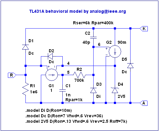

I thought I would post this -- it's just a simulation -- the standard TL431 model doesn't incorporate all of the reactive componenets in the device -- but does have the temperature dependent resistances fitted in -- some of the TI folks had pointed this out in 2005, so here's what the bode plot should look like -- note I put in 6dB gain block to lift the x-axis -- the graph on the left is the usual TI model, that on the left mirrors reality a bit more.

Anyway, here's the schematic of another TL431 macromodel, by analogspiceman of the LTSpice user's group. Also, Helmut Sennewald has done a device-level subcircuit based on the schematics from the datasheet (which have component values). I'll post the subcircuit files of those next.
I originally had a bunch of convergence problems with the primitive TI macromodel. I've had good success with convergence using the macromodel from analogspiceman. I've also compared the frequency domain data of open-loop gain and so forth, and the macromodel seems a bit closer to the datasheet than the device-level model. If you use these along with the LTSpice loop gain probe, you can see stability issues with various capacitive loads. Kind of neat. I've found them useful anyway.

Here's a comparison of Christophe Basso's model (from his book "Switch Mode Power Supplies") with Thompson - recently posted to the LTSpice Group over there on Yahoo:
both cross over at the same frequency.
and here's a Bode plot for a real Texas Instruments TL431:

An impressive and helpful job for simulation and understanding.
For those of us using the TL431 on a whim, I understand Figures 16 and 18 (Stability Boundary Conditions) of the datasheet such that the capacitive loading for safe operation should be either up to 1nF (capacitor tolerances taken into account) or above 10uF. Making sure that the parallel loading circuit remains below 1nF may be difficult, so, in practice the advice for DIYs is to give it 10uF between Anode and Cathode as a minimum?
Am I right here?
