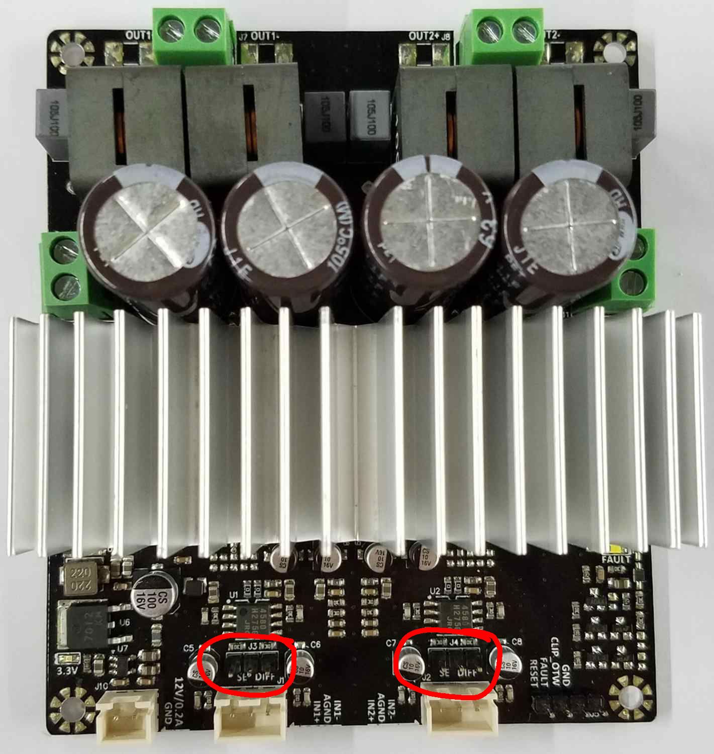

When I found some high rez photos of the board and zoomed in, I saw the jumper for the SE - DIFF setting, Thank you!

I have the new version of the amp with the thru-the-hole caps and the op-amps that can be easily swapped. I’m using the 3e 36V SMPS driving 8 ohm speakers. Sounds superb with just SE input and output. I have a DAC supplying a pre-amp used for volume & balance control. I can remove the pre-amp if I drive the digital signal to the DAC from the USB C output of an old cellphone (has a volume control; music streaming) directly into the amp.

Linuxfan, the input op-amp are socketed so there is nothing to stop you simply removing the opamps and driving your input signal straight into the output pin of the socket.
To me the design as it stands today is a perfect compromise between a board that is straightforward for less experienced user, whole still giving plenty of options for tweeking options for those with skills.
Btw. On the bottom of the board under the DIL sockets are footprints to fit SMD opamps...what more could you want?
Indeed. And that's exactly what I did with my 3e-audio amp board - the old version - by soldering wires onto the board -

The biggest improvement to this amp was bypassing the SE-to-differential input stage - of course for this you need a playback device with differential outputs.
