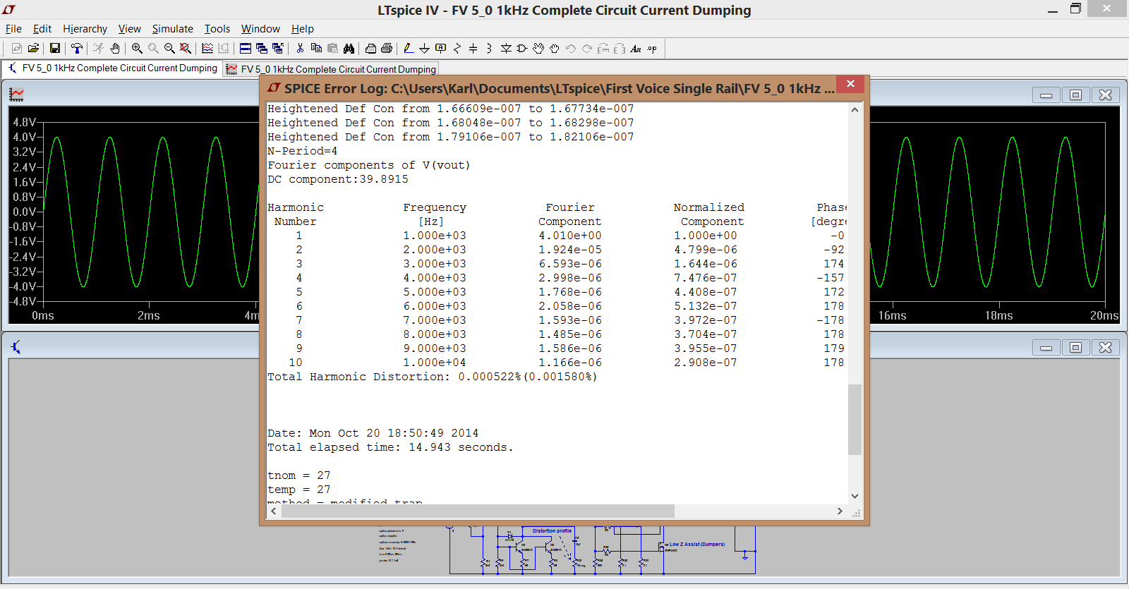

What's LTspice doing there?
I reran an old circuit of mine, and, the spice log reported two sets of values, with one in parenthesis. What does it mean? I had never seen that when I had launched this circuit previously.
I've just updated and I'm seeing this also.

Hmm.
Mike Engelhardt very kindly replied to me asking what was going on and the answer is...
The 2nd figure an alternative method of computing THD. It nominally includes
all harmonics but numerically difficulting in identifying the fundamental
limits it actually use. It's just bonus information for the guy that asked for
the feature. You can ignore it. But is the number is higher the previous
number, it is an indication that you didn't include enough harmonics in
your THD calculation.

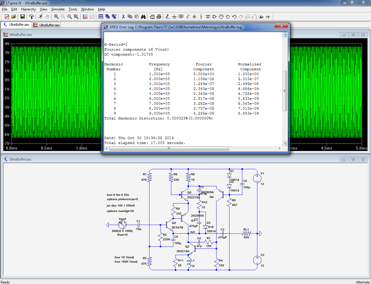

Quite strange: in the example I gave, the second figure is actually lower than the first (zero in fact)
Elvee, please send your schematic to Mike so he can look at the results. It seems there is clearly something wrong if the second number is vastly lower than the first number.
EDIT: Mike's explanation is full of grammar errors and very unclear. You must have caught him at a bad time. Maybe it's normal to have the second number lower for certain reasons but because of this I can't tell. Perhaps if the harmonics are buried in DC drift the second number can be lower and more accurate? Need more information...
