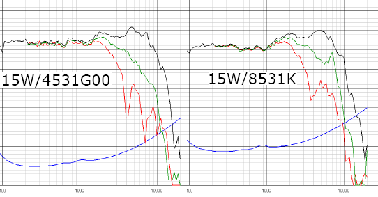

What peaky response do you mean?
The 15W Revelator is one of the smoothest mid-woofer I've ever measured!
Here are measurements for the 4 Ohm version of the un-coated 15W Revelator. ScanSpeak 15W/4531G00 Measurements!

Your measurement of the 8531G indeed looks very good. Here's different FR based on datasheet between 8531G and 8531K
