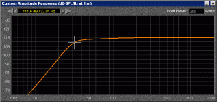

I recieved two free subwoofer drivers from a friend. Through a lot of searching, I got the manufacturer and they sent me these specs...
Fs= 16 Hz
VAS= 8.1 ft^3
Qts= 0.208
Qes= 0.217
Sd= 51.1 in^2
xmax= 0.23 in
Znom= 4 ohm
DCres= 3.6 ohm
PMax= 200W RMS
I have one suggestion of a sealed 1-2 ft^3 cabinet with a 120W plate amp.
What would you build with this for music and minimal HT?

The Vas is quite high, I would build a cabinet larger than that if you can. Those are 10 inchers?
Parameters seems wrong, or efficiency is really low... Xmax is low also...

I'm thinking dual sealed subs, active stereo crossover: >200Hz to existing amplifier <200Hz + Linkwitz Transform to new plate amps or chip amps.
That'll be about as 'musical' as you can get.

That sounds like a plan. Now...what box volume? I was looking at 2 cuft at the largest, but the SAF would go up with smaller boxes 🙂.
LT does let a smaller box work. But, as I am going to take some time (finances) to get that portion done, I might have to make a compromise...but a 1 cuft box would be okay to get me by for a while, I think.
Then, when the LT is in line, I'll be good to go. think that will work?

plugging given parameters in DPC you get:
Qm=5.02
Cms=1.510 (not very stiff)
BL=10.5
Mms=65.52
Spl 2.83V=91.5dB

Thanks for the numbers. What would you suggest building?

Not much is right. I am partial to the transient responses of a sealed enclosure and the info I got suggests a few sealed enclosure models up to 2cuft. It also gave possible outcomes for an infinite baffle.
Think I am okay for an IB application if I can get the SAF up? Where could I look for info about building them? Thanks!

Well, I built a 1.5 cuft box, tuned to ~31Hz (~9" port, 3" diameter).
It seems to fill in nicely, but I seem to think it gets honky. It's not a fantastic driver, so I wonder if that is the problem. It also is SPL limited as it is only one 10" driver....no chest compression. But as not the point, I'm okay with that. It is also not completely sealed on one side....just clamped for testing it out,
Any suggestions on the honkiness? The port is more than 1-diameter from any other surface.

Try putting a little stuffing in the port. Use the other sock that wasn't stolen by the dryer.
