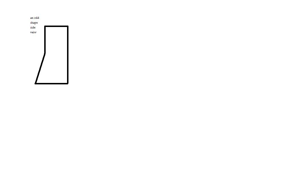

nelson pass once said that its very hard to better(if at all) the sound of a current output valve amp with full range speakers.............
hav'ing said that i would go for 2x 6" per channel for the bass, angled so the centre of the outputs(sound)of the speakers meets at about 7' from the drives. with say a 3" and tweeter dome, keeping all the drives as close as possible on the front of the cabinet which would need to be an odd shape.
also a 3way 2nd order x over should sound ok

My take off the top of my head is that if you are not going to biamp then you should go for efficient midwoofs with a broad smooth frequency response and a smooth impedance curve. The goal is to allow it to run up relatively high and use the simplest low pass possible (preferably first order). If you can get a full range with solid low end performance so much the better. In some cases no low pass is needed at all and this is ideal IMO.
Now you will need a tweeter (or helper tweeter) of high efficiency that can be run low enough to blend smoothly with the woofer with a simple high pass filter. Again first order is preferred. A nice compression horn might be a good choice here.
For enclosure I would suggest either open baffle or something that tends to flatten the impedance curve such as aperiodic, back loaded horn or 1/4 wave (TL).
The more appropriate the drivers chosen are the less complicated the crossover will need to be which is desirable.
