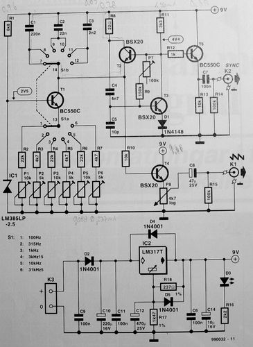

i have one schematic for making the sawtooth
that i described in prev post
it is from one Elektuur article way back
I even have made my own sawtooth generator circuit.
1. You have to use very fast switching transistor for the rising square.
High slewrate, low rise micro seconds value of transistor.
2. Then you have one capacitor to detect the top limit
and begin the 'slow' sloop until another lower limit
which will trigger
3. the fast rise transistor again
Not too difficult or complicated to do discrete with a handful of suitable transistors.
I took what transistors I had in
my personal re-use supply = desoldered from old PC and radio circuits.
And it worked pretty well, even if those transistors was not the same as in Elektuur article.

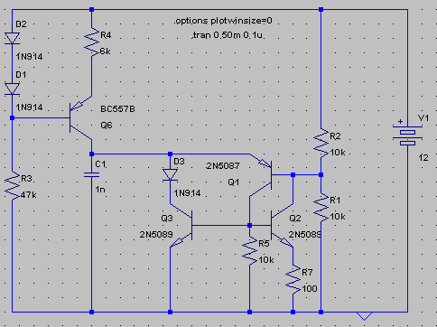

At any rate, here's what I know about analog sweep generators, of the cap-charge variety:
1: Cap must be fed with a good CCS, with low Cj transistor, which is especially important at high frequencies.
2: Discharge device should draw as little current at idle as possible, to keep constant current through the capacitor.
3: good cap is needed. Electrolytics aren't required. 60Hz can easily be made with a 100n cap.
4: if output is connected directly to charging capacitor, it must be a VERY high-impedance amp or other. From what I know, CRTs have basically infinite impedance, so perhaps the CRT plates can themselves be used as the capacitor.
That said, here is the circuit I've been messing with for a while. Once I have the parts and time, I will attempt to build it. It simulates fairly well.
Q1 and Q2 for a PUT pair/SCR thingy, which CAN be run without Q3. However, this limits the high frequency possibilities. Without Q3 the highest is about 20KHz and if you're lucky 40KHz. With Q3 it is possible to go in the 100's of KHz with still decent waveforms.
In certain situations bypassing R7 a 10p cap will help if you can't get it to start. Putting a small resistor in series with the capacitor may help in some situations as well.
Frequency is easily controlled via R4, which can be some sort of POT.
Unfortunately, the PUT pair relies on Q1's Vbe to fire at the right voltage, so unless some kind of frequency locking/compensation/correction is implemented, it is perhaps not suitable for use in the freezer or oven.
As should be expected, all devices should have low Cj and high gain is beneficial.
A two-transistor arrangement was tried for the CCS, but the current arrangement is now used because of lower parasitics.
R5 keeps idle current draw from Q1 and Q3 minimal, but it can be higher, say 100K or 1meg.
Overall, it is a very simple circuit. However, for different needs it may need to be adapted. HF performance and harmonics can be improved most easily by inserting small resistor values in certain places bypassed with a 10p cap. Various tweaks can be made Via HF coupling in order to make the edges of the sweep sharper (=more HF harmonics). A 10p across D1 might help edge sharpness a bit.
Currently, output must be taken from Q1's emitter, which may cause problems. I have not found a suitable Hi-Z impedance matching solution for this.
At any rate, I hope it deserves my descripion, enjoy.
P.S.
D3 can be omitted and replaced in series with R2 so the circuit will give full 0-6V sweeps instead of 0.6-6.6 (or whatever set by the ratio of R2 and R1). However, if a bipolar NPN is hooked up to sample the output, the 0.6V boost is helpful.
- keantoken

here's circuit
Published Article:
Elektor, Elektuur 1999 March #3
The article also describes some examples how to use
Inverted Sawtooth wave
which probably is the correct name for this wave.
