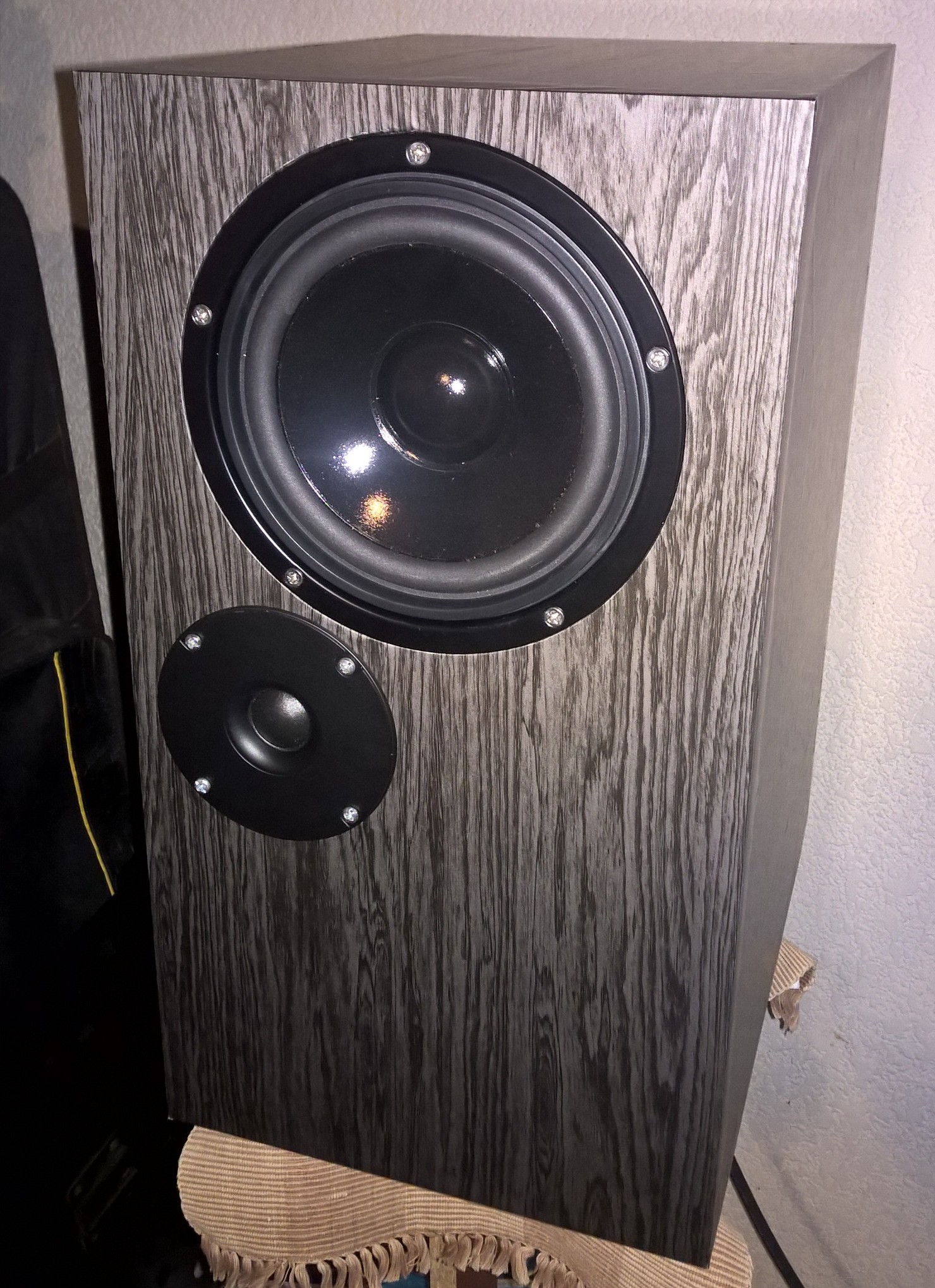

Hi All,
I have recently acquired a pair of Arcaydis EB2s speakers.. Slightly unconventional in their configuration, with a 20l sealed box design.
EB2S – Arcaydis
I was thinking of upgrading the mid/woofer to a higher-spec unit, but I am still learning about driver parameters and their effect on the sound.

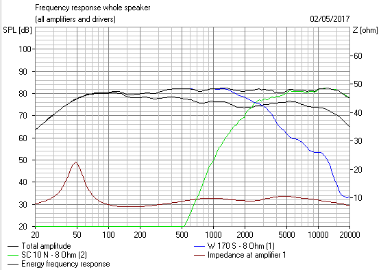

That is just one of about a dozen ways to do a filter for this style. We went for a flat impedance idea just for the interest. But the filter works at every level IMO:
614628d1493770508-visaton-2-tower-monitor-audio-bronze-5-a-marc-circuit-png
614629d1493770508-visaton-2-tower-monitor-audio-bronze-5-a-marc-fr-png
What I would do, in your position, is evaluate the crossover thoroughly. Draw the schematic. Then we can see if there are any glaring faults with it. Or how specifically tailored it is to the driver. Easy enough to sim your speaker: Downloads.
Changing the woofer might be the least interesting thing you can do. You might, for instance, find that a different style of tweeter does far more to make the sound more to your taste. And notching or reducing the 5kHz cone breakup is very audible.

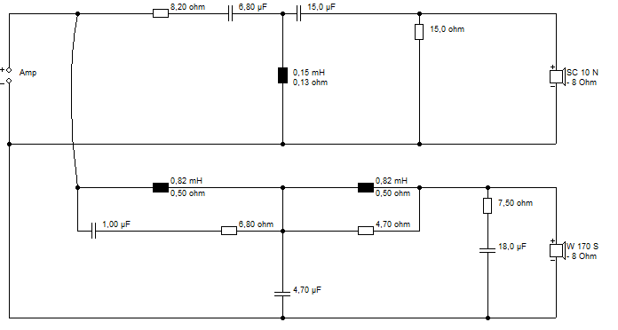

D Marsden, crossovers are specific to drivers when well executed. If you draw up the schematic, or post a photo of it with the paperclip thingie, you can then have an idea what can be fixed.
That W170S is a very good woofer by all accounts. It often benefits from a notch around 5.5kHz, as do most 6" drivers. That is simple enough to do. Needs about a 15R resistor and 1uF capacitor across the bass coil. Parts cost about £5 at Maplin.
And, FWIW, once I see the filter, I can have a simulation running in about 5 minutes, which might reveal what your ears aren't liking. Commercial product often skimp on filters.

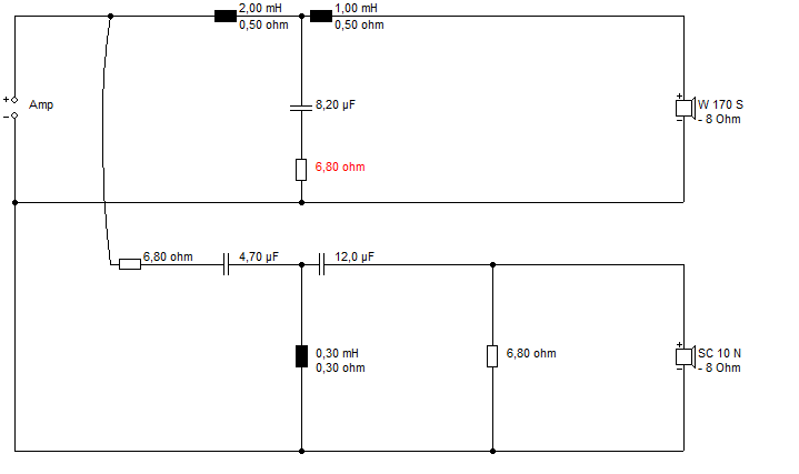

That looks pretty reasonable, except for dreadful coil layout. Might be a BW3 design:
627371d1500943361-classic-monitor-designs-monitor-audio-ma7-circuit-png
Ignore the red impedance correction.
You need to trace the circuit, and get the capacitor and 4 band resistance values from the standard colour codes. I can probably wing it on the coils.

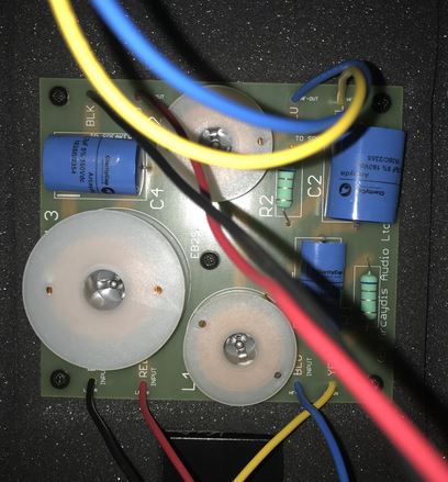

Steve, could I get your expert advice to reach a conclusion on this old thread? It might help other EB2S owners like me.
I shared Paul Messenger’s assessment of them:
‘listening to music programming at higher volume levels, did have a degree of ‘forwardness’ that could become a tad wearing, depending upon the mix.’
The majority of the time I’m not listening at higher volume levels so it’s only a minor irritation. It could be a down to the room acoustics but Paul Messenger’s review did make me wonder. Based on his in-room far-field averaged measurements he noted:
‘A very slight trend in the overall output maximises output above 600Hz while minimising output below that point, which possibly helps project vocals slightly.’
Other than that he was impressed by his measurements:
‘Much of the band holds comfortably within ±3dB (or even tighter!) limits, so superior neutrality is guaranteed. The bass extension is pretty good too, registering -2dB at 30Hz and -9dB at 20Hz under our far-field measure, alongside a relatively even, albeit slightly dry balance. For the record, the main driver/box resonance occurs here at 64Hz.’
He also measured the impedance as ‘remaining above eight ohms throughout’. Though EB2S specs give minimum impedance as 5.9ohms. That is the value for Rdc in Visaton’s specs for the 8ohm W 170 S. The tweeter is Monacor DT-99 btw.
I’m not looking to replace either of the drivers. I would consider modifying/changing the crossover if there were glaring faults. Your view in #11 was that it looked reasonable apart from dreadful coil positioning. So that might point to some judicious use of EQ software to make a fix.
From the photo taken by original poster it’s difficult to make out the values on the three caps. R1 & R2 both appear to be 6.8 ohms (if they are blue/grey/gold/gold). It looks like (to a rank amateur) that the crossover components for W 170 S is one coil and one cap (L3 & C4); and for tweeter there are 2 coils (L1 & L2), 2 caps (C1 & C2) and 2 resistors (R1 & R2). Tracing the circuit as you requested would involve unscrewing the crossover which, as a complete DIY beginner, I’m wary of doing.
To demonstrate some rolling up of sleeves I did look at the Claritycap website. Their PWA range are 160Vdc. Going by values available there (http://www.claritycap.co.uk/products/pwa.php) C2 could be 22uF and C4 could be 2.2uF. Printing on C1 is obscured by red and black wires. Puzzled by lack of C3?
Are you able wing it completely with this (albeit sketchy) additional info?

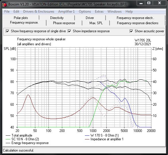

I just had a look at this, based on the complete lack of crossover tracing that has been done so far. Seem to pick out two 6.8R resistors, a 8.2uF on the bass and possibly 4.7uF and 12uF on the tweeter.
15 minutes work in Boxsim 1.2 and I might have found the problem of forwardness here. But a compete guess on the filter. So I really can't guarantee anything.
If that is a third order bass filter, the 8.2uF shunt needs some resistance added, I tried 6.8R. Otherwise it's very peaky at 1.8kHz.

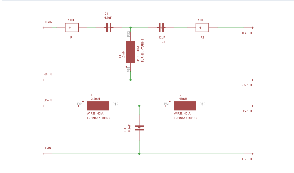

TRACE THE CIRCUIT! OTHERWISE WE ARE GUESSING....

I appreciate you taking time to run the FR prediction in Boxsim 1.2 and for your educated guess on crossover layout and component values.
I was able to get the crossover circuit diagram from one of the partners in Arcaydis Audio (which is no longer trading but he is still in the business – Matrix Pro-audio).
Look how close you were with your guesswork!
All the values on tweeter filter are correct – only difference is R2 is in series with C2. It is a third order bass filter and your C4 value is correct – just slightly out on the coil values: L2 is 0.45mH and L3 is 2.2mH.
Now we are in the know can we conclude that the problem of forwardness is the peaky response at 1.8kHz as you suspected? Are the different coil values on the bass filter (or different position of R2 on tweeter filter) likely to alter the FR predicted by Boxsim? If so would you mind running it again please as my initial plan is to address the problem with EQ software (FFMPEG equaliser) and I’d need to have an idea of the height and width of predicted peak at 1.8kHz, and if any other frequencies need correcting.
If didn’t have option to use EQ software (e.g. I used a CD player) then I’d be looking to add a resistor to the bass shunt as you recommended. A couple of questions about doing that: (a) would you still say 6.8R? and (b) how easy would it be to fit that resistor given that space on pcb is tight?
