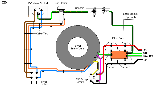

My toroidy 2 x 18V 500VA
has a earth-wire (yellow-green) accompanying the 2 primaries.
Looking through the build-guides as well as sound-au's Power Supply Wiring Guidelines doesn't show this detail.
Do I connect it to the power-connection, to the chassis before the cl60, or after (together with the PSU's ground?)
My instinct tells me to hook it up as soon after the power-inlet/switch/fuse as possible...
thanks for confirmation!

The wire is likely a shield between primary and secondary, like the purple wire in the diagram for this transformer:
AS-3224 - 300VA 24V Transformer - AnTek Products Corp
Connect the wire directly to earth ground.
For safety reasons I'd connect this wire to the IEC mains socket's PE lug, not to the chassis or something else.

As the purpose of a shield winding is minimized primary-secondary coupling, it generally connects to secondary-side ground so it can form an electrostatic shield for that. As that in turn usually connects to chassis and chassis would connect to PE in an IEC Class I device, that makes all of the above just about equivalent.
That said, the shield winding is primarily of importance in an IEC Class II application where it greatly reduces mains leakage current - with big transformers leakage capacitance can reach around 1 nF or more otherwise, a shield tends to reduce that by more than an order of magnitude. If you can just dump leakage current into PE the shield winding is basically wasted.
How critical this is will depend heavily on the kind of inputs used and how they are implemented. For a traditional hi-fi amplifier with straightforward unbalanced inputs, going Class II is highly recommended. (If gilding the lily is your thing, you can additionally bring in PE just to connect a smallish Y2 rated capacitor from chassis to that - with a shield winding, this could be as small as 1-2.2 nF while still reducing any remaining mains leakage substantially. PE should probably be treated as just another mains wire in terms of insulation then.)
If you want balanced inputs, going IEC Class I with AES48-2005 compliant input wiring is generally encouraged.

Nothing to do with the transformer shield, but the diagram in post #1 shows the live line fuse after the on-off switch.
The safest location for the fuse is immediately after the IEC socket.

Very good point, i never looked at the diagram..
Ground the chassis immediately after the IEC socket, fuse directly after the IEC socket.
Basically what ferret said.
It keeps the live electricity out of the case. Wired as shown in the diagram, there is a live wire from the IEC connector to the switch and then back to the fuse, even with the fuse blown.
